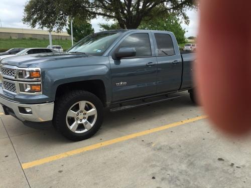

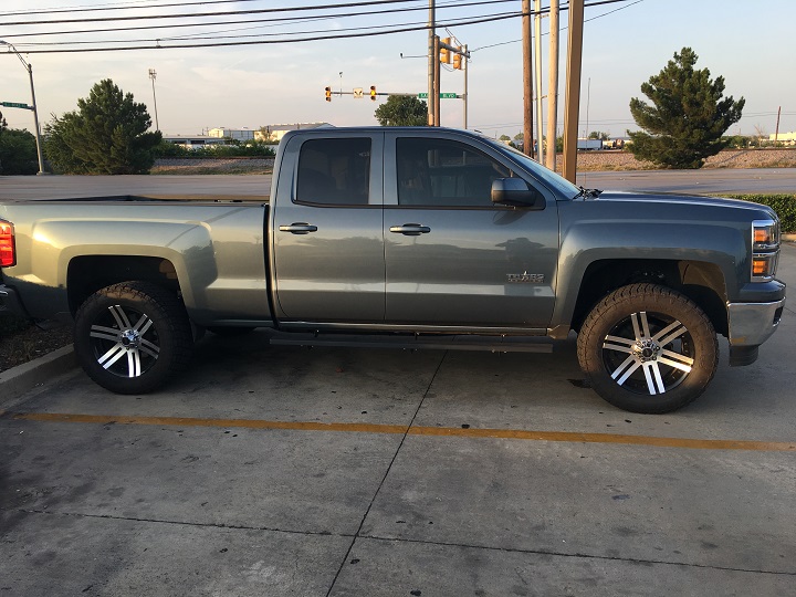

Newbie here......I will get some pics up tomorrow. I have a 2014 Silverado 2wd that I just put a RC 2.5 level and Terra grapplers (305/55R20) that I put on stock rims. I have slight rubbing at back of liner on full lock only. No other rubbing that I can tell during daily driving at this time. I love the set up.

Its been great. I have changed from the stockers to some aftermarket rims with a +10 offset and it actually doesn't rub as much anymore in reverse. Wouldn't change anything else.
