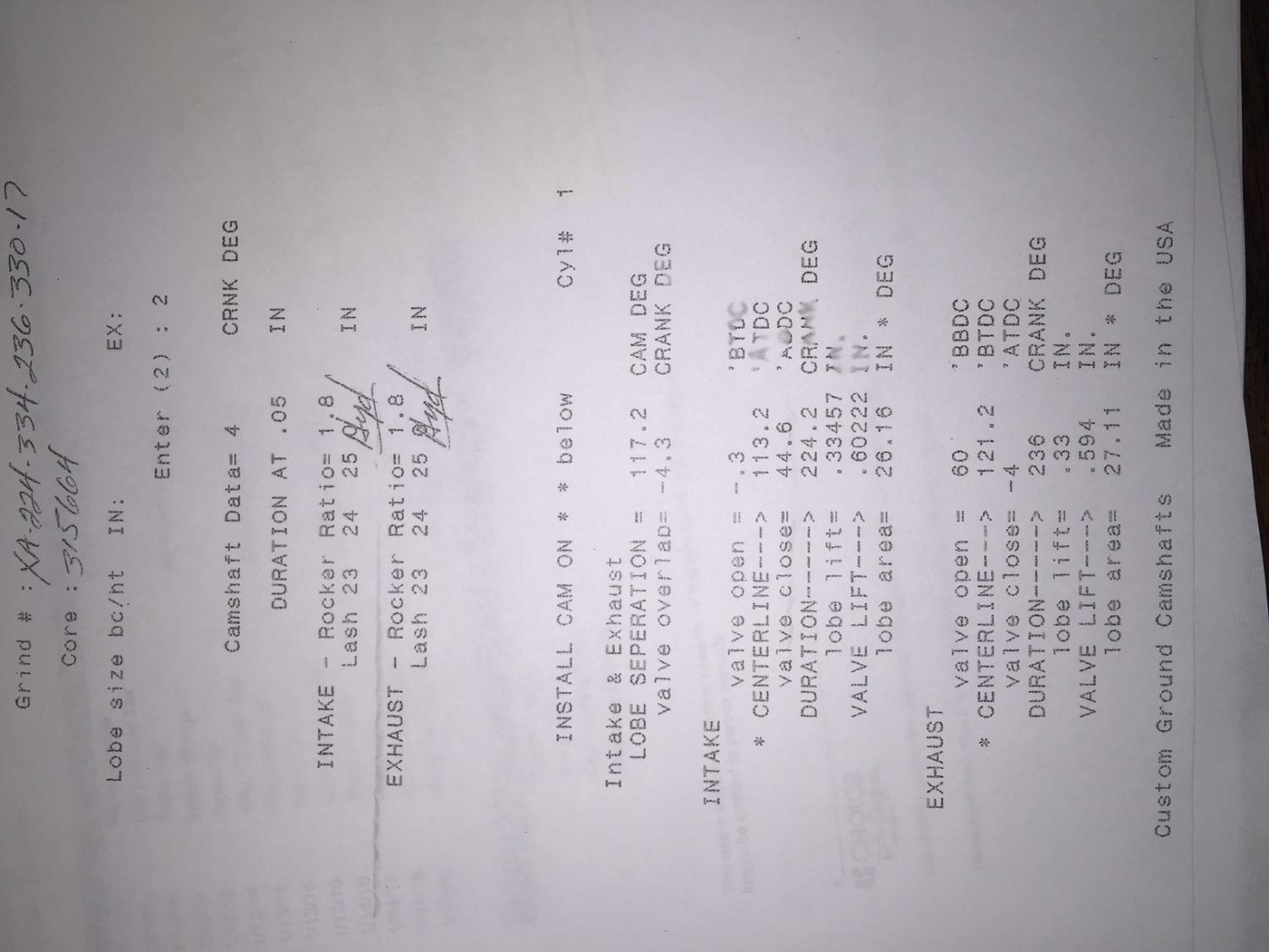

This is the cam going in this week...Should be great to play with
Looks like a mild cam.... That should open her up oj the big end quite a bit!!

yes sir it is mild, you don't need much with the Whipple....My first cam was basically stock smooth idle with the fuel lobe changed
