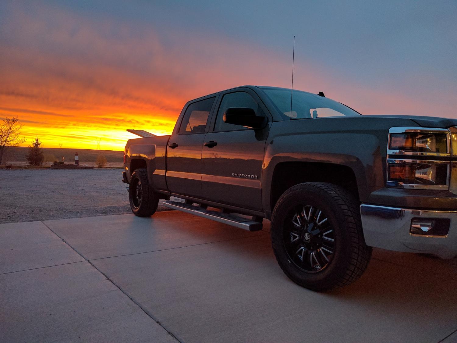

Pics please..
Looks awesome! Did you notice any difference in the ride quality? Have you noticed much loss in MPG?
Im sure uou could run 275/60/20. With out a lift. My tires aren't even 33" tall. Love the look. Lost about 3 mpg but ive 2.5 RC LIFT front only. Going 295/55/20. After the holidays u can do it with out a lift. Byw. Ive bfgKO2 there awesome no noise driving fast at all and look great 2 me
I don't own the truck anymore but the 275/60R20 michelin LTX M/S2's were definitely an improved ride quality over the factory Goodyears. You can install them without a lift or level, no problem.
I ended up installing a Rough Country 2" front level which gave the truck a much improved more aggressive look.
With the truck being level it drove better and didn't dive forward anymore when I did a quick stop.
I didn't notice any MPG lose, however I wasn't really looking for it. The truck still continued to get great gas mileage.
Anybody on the fence about the 275/60/R20 michelin LTX MS2 tires and the Rough Country 2" level need to just do it, you will be pleasantly surprised.

I am almost certain the Michelin LTX tires are THE best truck tires you can buy if you are looking for an overall best ride quality, milage, dry and wet weather grip. On my 2006 Ram 2500 the factory LTX's ran over 80,000. Sure off-road performance was almost non existent but it was overall a great tire.
They are a little pricey but I'm glad I saw your pictures. They look good on the factory wheels.

Just put some (275/60R20 Cooper H/T Plus with -12 offset rims) on a 2014 Silverado only leveled with Bilstein 5100's. Doesn't rub going forward at all, maybe if you hit a bump on full turn but I tried some turns at full with no run. DOES rub in reverse at just a titch before full turn in either direction. Very noticeable rub but nothing that will hurt anything. Again this is with a -12 offset rim. Sounds like stock offset rims will not rub.
