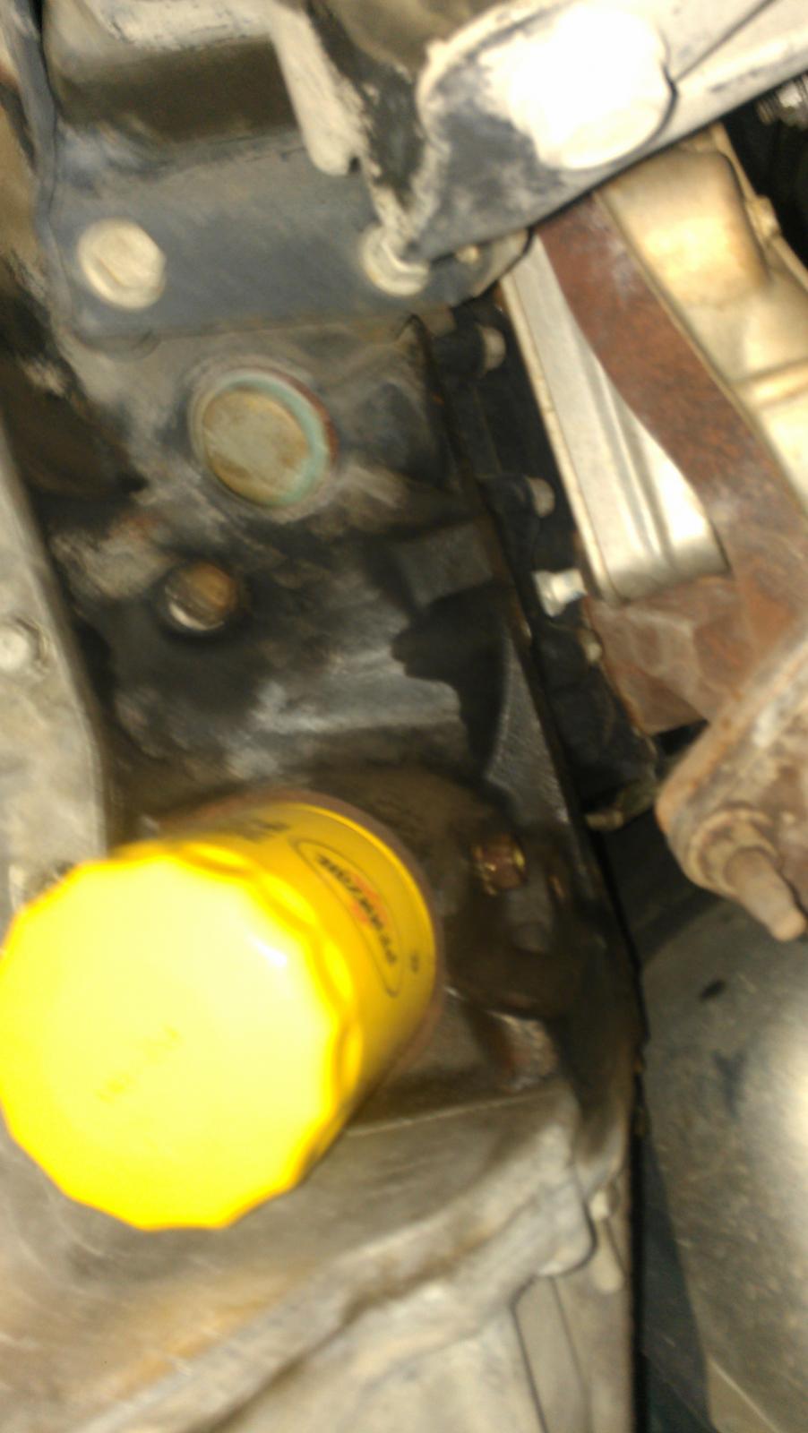

* I just went out there after some hard driving and see fresh oil stains. I'll take pics tommorow. There normally isn't stains on my drive way, my friend actually thinks it's some thing that leaks only when the truck is running.
Unfortunately I can not view your gallery right this moment and your previous pic is a little too blurry. However, give the engine (cold) a bath and then after it dries out real good take it out and drive it hard (ish) and then take a look. What you want to see is where is the highest point of where you see oil. From there you should be able to get a better idea of what you are looking at. It good be a few different things. Once I get a chance I will view your gallery and see if anything jumps out at me.

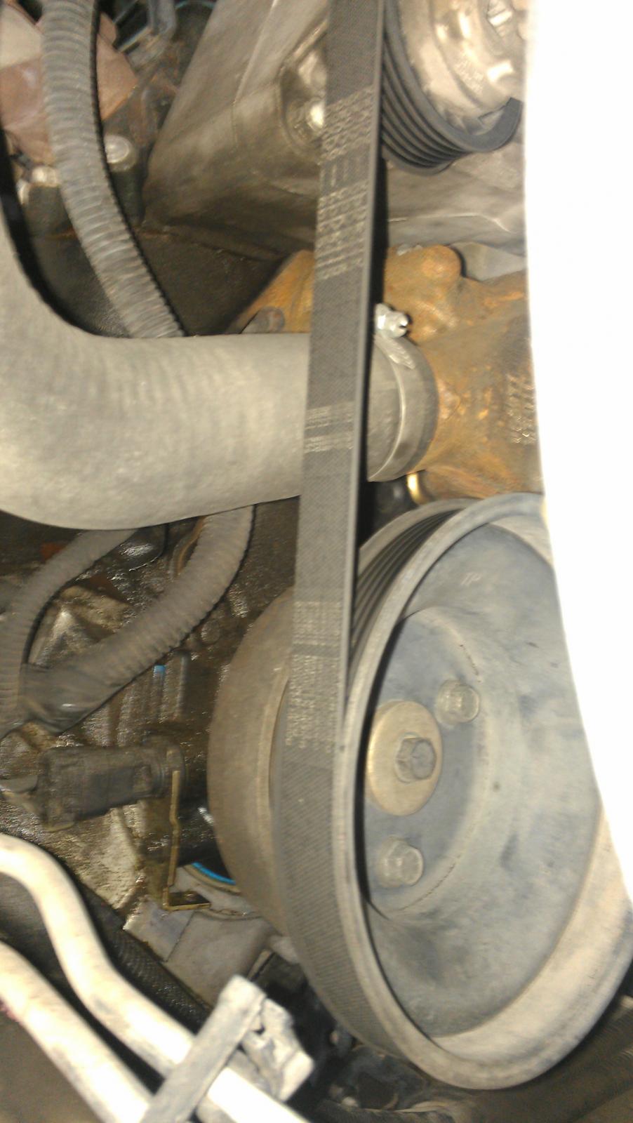

The second shop says its the Front Cover Seal Leaking, .
I suspect my timing cover seal is leaking as well.
I would thoroughly clean the area (as others suggested). Get some aerosol foot powder and (once surface is dry) apply liberally around suspect area. This may help identify leak's origin.
I would not blast down the highway, as oil blows everywhere. Rather warm to operating temp, and slowly take it around the block. Get under and check for leak.
PS: If you attempt seal replacement, suggest you get a new water pump (as you have to take if off anyway). They're only $30 - $50.
Water Pump has already been replaced according to previous owner. I'm gonna clean her up real good tommorow morning once she cools. That's a good idea foot powder? can I use baby powder to?
My friend told me it was the rear, he's a ford technician, but he's only going off of the pictures I showed him, he is 100 miles away. I am hoping to dear God it's not. I took the Truck to another trusted shop where the dude said it was the front, which makes sense I know my rack and Pinion is bad but above it is where it's leaking oil to. Which would explain why I see both oils... and why the oil down the highway drains down toward the rear seal but isn't leaking from the rear seal. Make sense???
