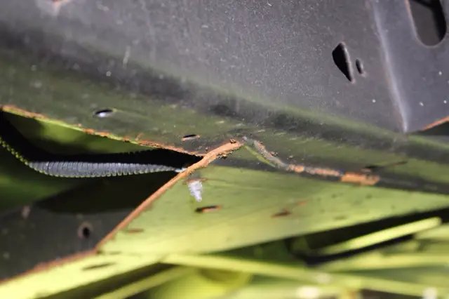

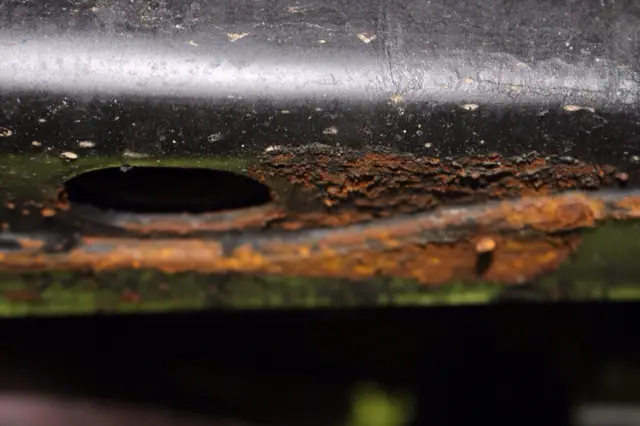

Here are a few, basically every edge, every weld joint, rear cover, big places on the frame.

I like the middle picture, the paper label still looks like new but the frame looks like it is 15 years old. Maybe they should make the frame out of that new kind of paper you have there. Now I'm going to have to check mine out and obsessively worry about it looking like that in a couple months.

That actually looks pretty damn good considering some of the other trucks I've seen. I can see why they didn't want to work on your truck. While it's unreasonable to have rust on any new vehicle, the fact of the matter is your truck (and mine as well) look nothing like the trucks where sheets of the wax coating were just falling off all over the place. Those are the trucks that are getting the full repair done where they strip and re-coat the frame. Your truck will probably just get a once over with some 3M rubberized undercoating like mine did. Basically the middle finger from GM. I've decided to live with it this truck will be long gone before there are every any issues from rust. It's pretty much just a cosmetic issue.
