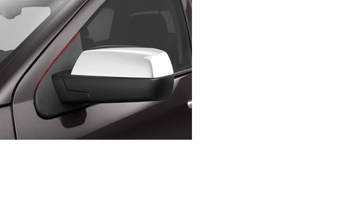

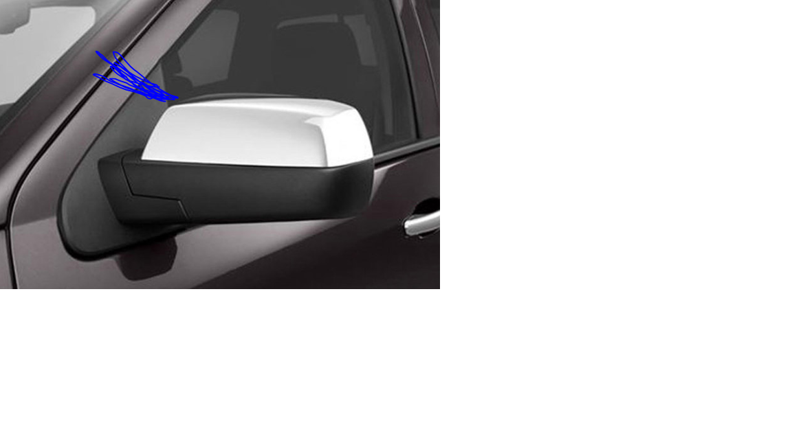

I had an issue with wind noise. Dealer could not find it. I know you said they taped up the door and the noise went away, but you should redo the test yourself.
My leak was in the same place as the attached image (red). It disappeared when i taped up the mirror. It sounded like the wind was coming in over my ear.
My suggestion would be for you to tape up your mirror, go for a drive and see.
If it stops, you know you have a leak here. I used some gasket sealer between the door and gasket and the gasket and mirror (red line) and then opened the door,  let down the window and wrapped tape around the window frame and mirror plastic to compress the gap and close it while the gasket sealer cured  (blue line).
It  worked.
Don't go messing with your hinges just yet.
