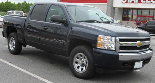

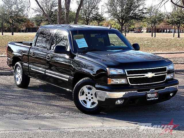

The gmt 800 platform ran from 1999 to 2006 but they produced them into 2007 as a classic model. Basically the classic is meant to bridge the older platform with the newer platform.
