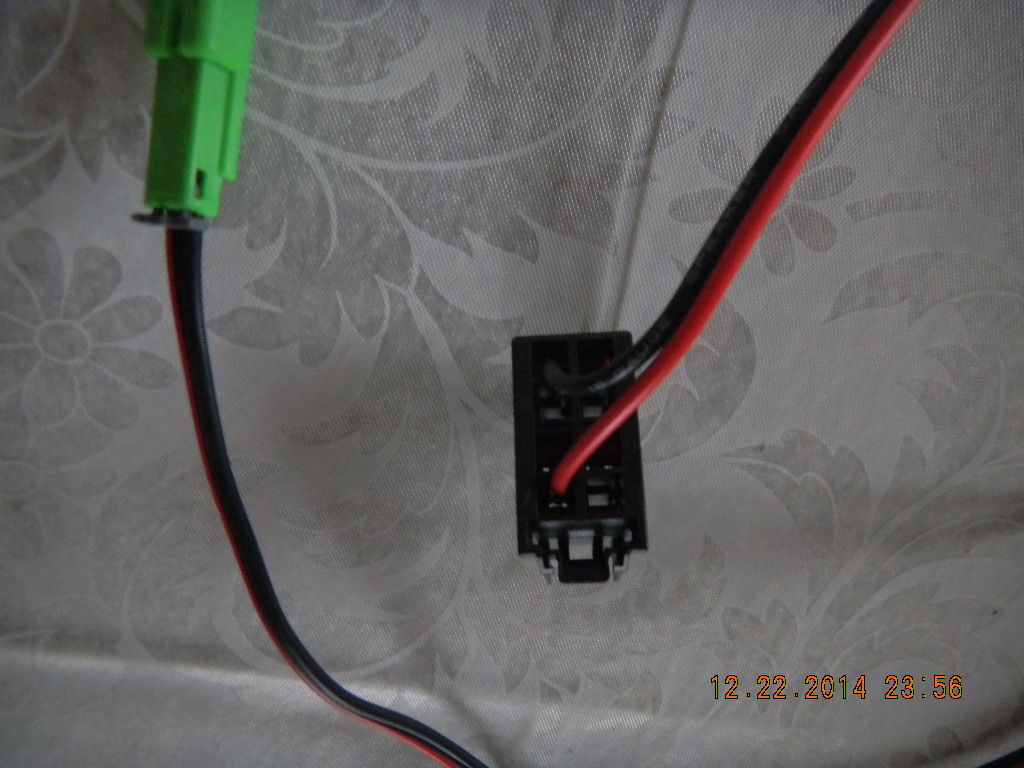

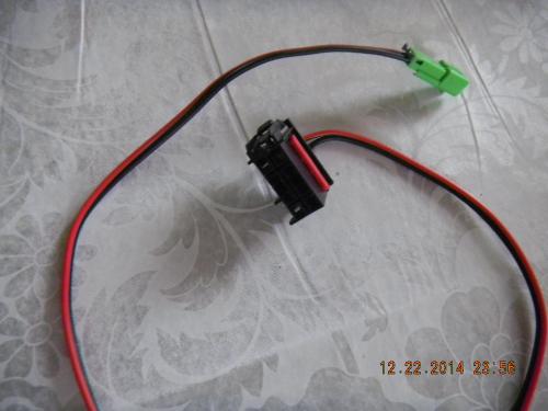

Harness to provide power and ground for heated steering wheel install. This harness connects to the dash side of the SIR coil light green connector and goes to the I/P Junction Block space X14. Delphi connectors, terminals, terminal locks and 18 gauge wire. $25 shipped in USA. Will ship to Canada $30.post-132989-0-43968200-1419354833_thumb.jpgpost-132989-0-60935300-1419354870_thumb.jpgpost-132989-0-03175600-1419354906_thumb.jpg

The new clock spring has all the connectors of the original clock spring PLUS a light green connector on each side. Steering wheel side connects to the heated steering wheel. Column side is where my harness comes in. It connects to the clock spring and I/P Junction Block. Once installed heated wheel is ready to use. No BCM programming/flashing required.

Yes. It should be plug and play on a 2013. You should verify you have 12v at pin 7 of X14 in the under dash junction block ONLY when the key is ON. I have verified that for 2011, but do not have a 2013 to check, but think it should be the same.
