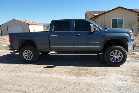

Cranked the T-bars up 1 1/2 inches. Installed Cooper ST Maxx 295/70/18's.
Thanks to everyone for their advice and guidance. I like the way it turned out.

Looks good! Why do I feel, although they are square in design, that the wheel houses look bigger than the last two design trucks?

Looks great!!! Let us know if you notice any difference in ride with the t-bars cranked a little. Though the larger tires should help offset if so. But maybe your lucky down there in MS with better road conditions than we have here in MI. Lol

Looks great man! Makes it look like a whole different truck. Do you how many turns it took to raise it 1.5" in the front? And how much rake is left?

I'm not sure exactly how many turns I made but like others One full turn netted about 1/4 inch. My front was 40" and rear was 43" now front is 41.5" and rear 43" (measured before tires were installed) so I got 1.5" of rake.

I will guess at 6 turns? Figure 2/10ths inch per turn, 6 turns, 1.5" total. I did 5 turns, changed about 1.2inches.
