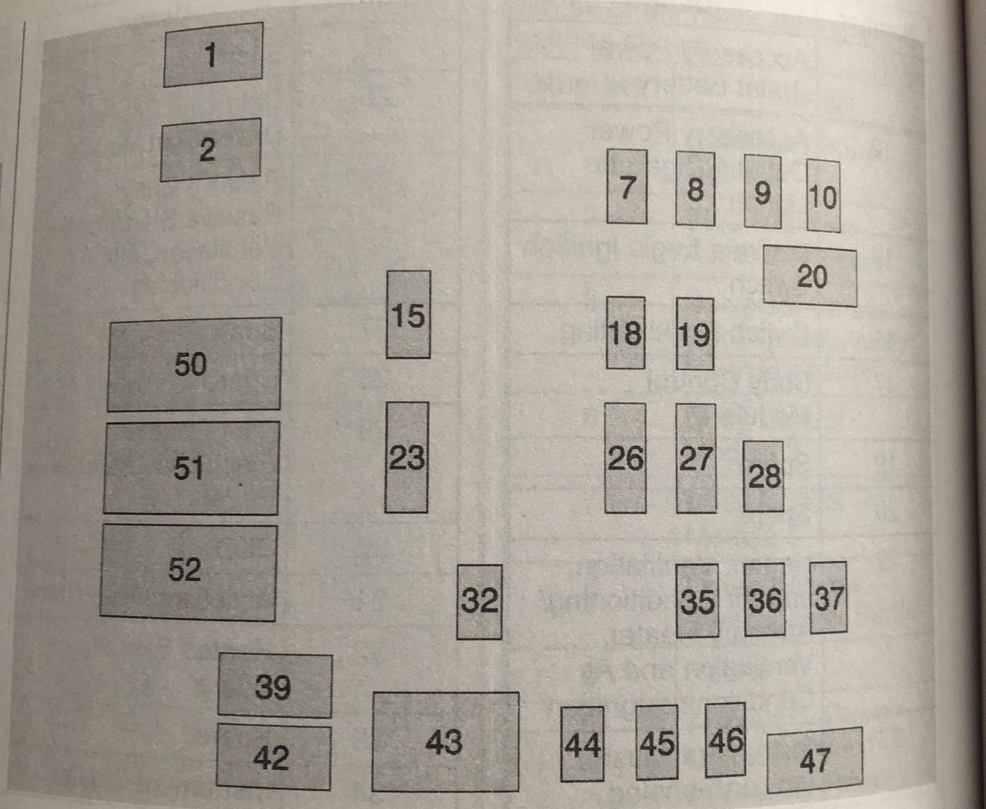

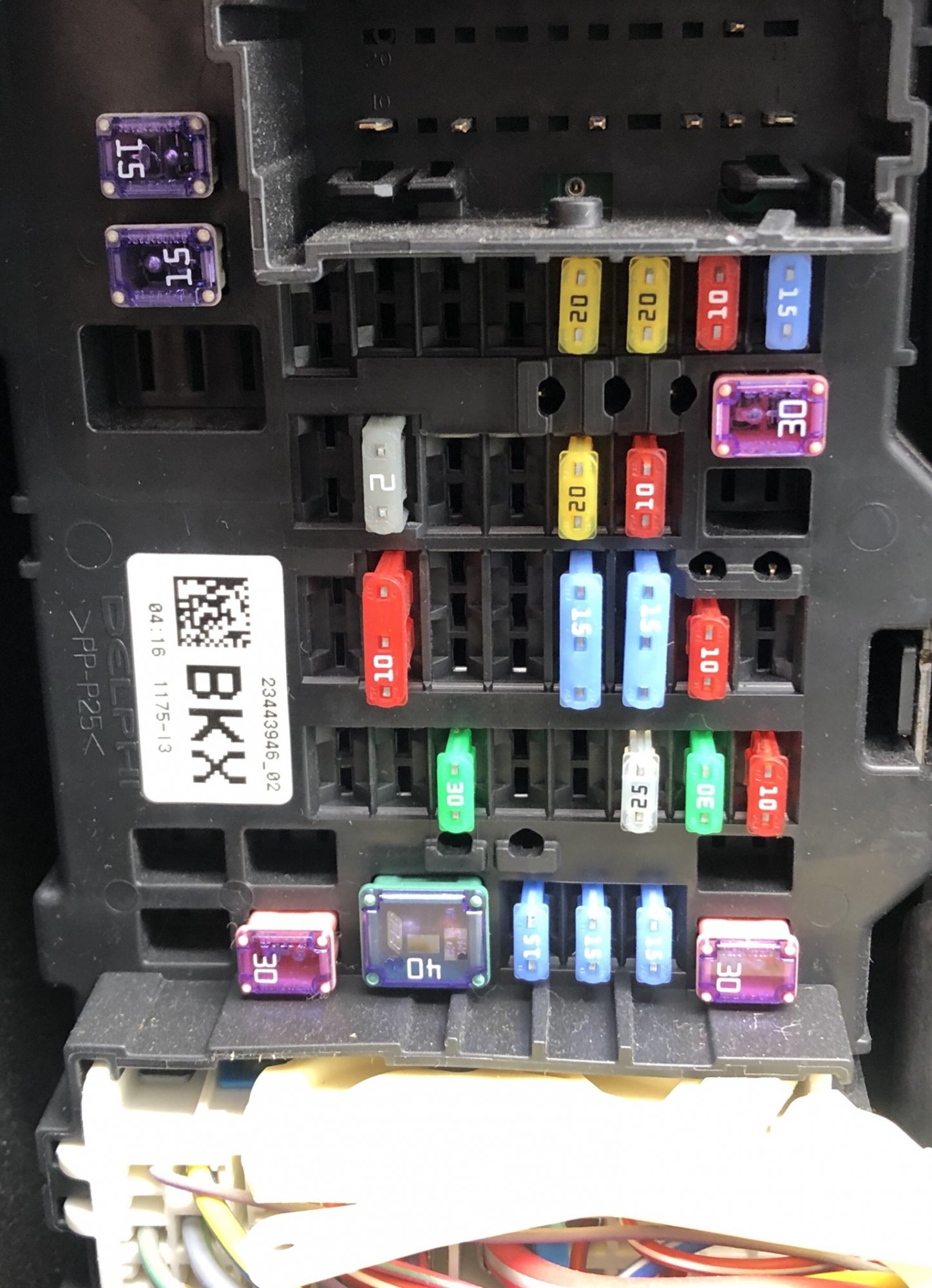

Does anyone know what fuse / location for power outlet on the back of the center console ( bench seat ) ???
One of the other “Retained Accessory Fuses” is labeled as #50 in the passenger side fuse panel.
But...  I just checked and when the diagram in the manual is lined up with the actual panel, there is nothing there. Love when that happens  ?
If anyone can shed light on that I’d appreciate it too.

I have the same question about my 2015 sierra.  Tge wording I the manual also states the RAP is always on and cannot be changed. When I look at the passenger side fuse box containing the RAP fuse block there are only 2 pins and no other position available to move it... anyone figure this out yet?
Earlier and later models all work the same as described in previous posts... move the fuse one position over.
Why would the 2015 alone be the exception.
AM I just not looking at all possible fuse locations?
Edited by Msstategrad
Typo
The one you move is on driver's side
