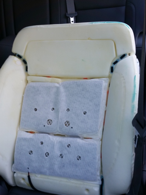

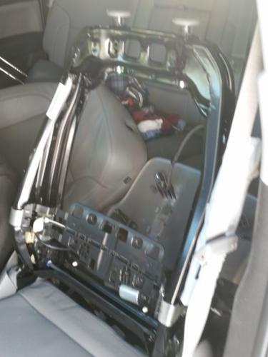

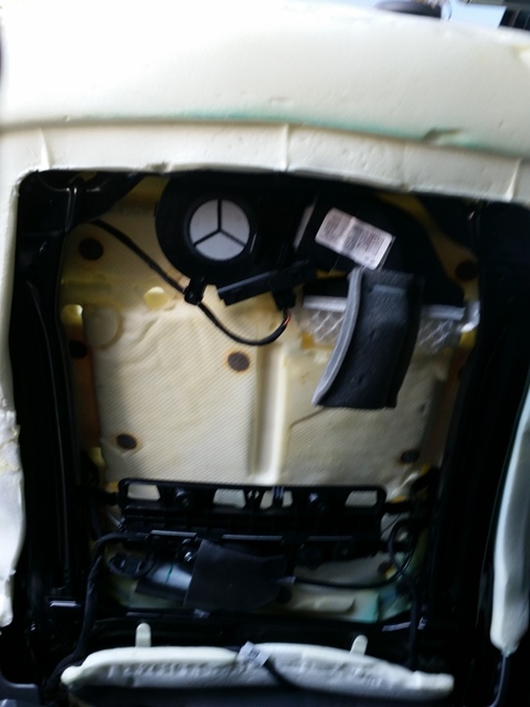

So this morning I was hell bent on tearing apart my seat and seeing what I might be able to do. Instead of taking the whole seat out I was able to remove the leather cover and foam from the seat while in the truck.

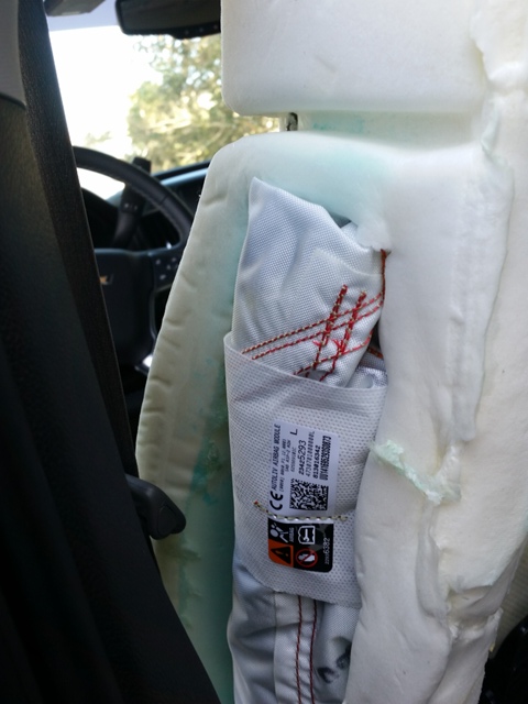

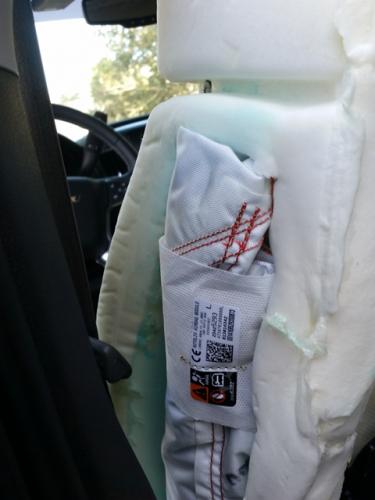

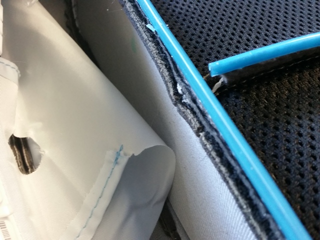

The seat comes apart fairly easy if you take your time,remove the headrest and once you have the back off the cover is held on with plastic hooks the connect to the frame of the seat , then the cover attaches to the foam by way of a blue plastic track that snaps into a orange piece the foam . then you have to unhook a strap that goes around the air bag. Then I found it easier to unbolt and disconnect the wire for the air motor and then unplug the wire at the bottom for the heater. Then just wiggle and puul the foam over the headrest post and wa la the foam is out.

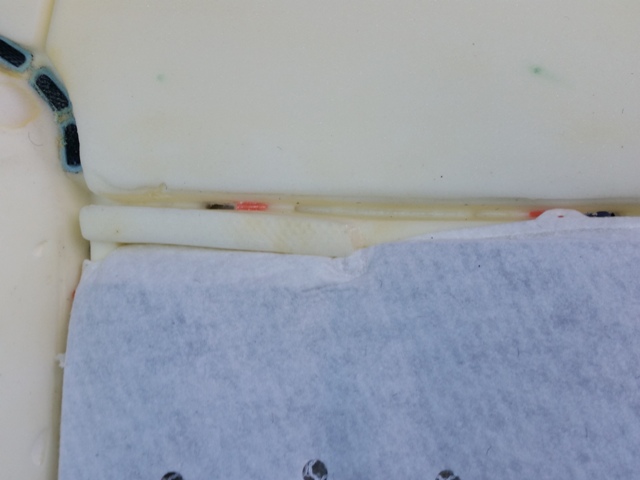

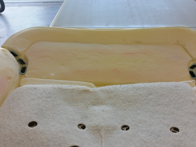

Once out and laying on the table I think you can see that the foam has a small little part at the top to level out the area due to the air/ heated part, the part that was bothering me was just above that where I'm pointing. So I took out my angle grinder with a sanding disc and proceeded to grind away some foam, after several test fits and about a half inch of foam ground away I put it all back together just to take it apart one more time. One thing I noticed was there is a small metal round bar that goes up and round the seat for support and I'm not sure yet but that might need to be bent back a tad.
The seat went back together ok but the blue peice that snaps into the orange piece is a bit of a pain to get snapped back together , once everything was back in the seat looks normal as if nothing was ever done. It feels better but I won't know for sure till I take it out for about a 30-45 minute ride. I will post back soon my findings, if this works and your not comfortable doing this type of repair I'm sure a local upholstery shop can handle it .
