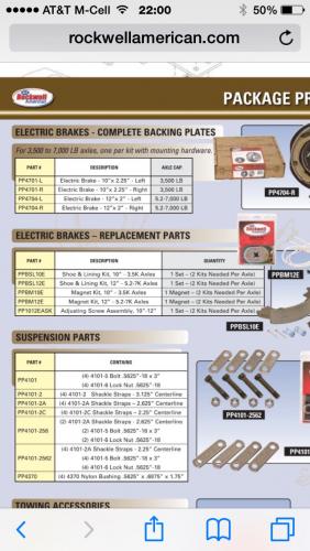

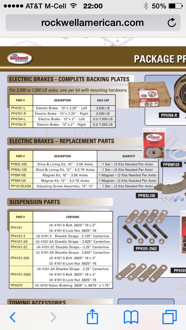

Here is a picture of Rockwell American parts number for their shackle kit...
Do I need the 2.25 straps or 2.625 ?
Guess I can go measure the leaf springs but it's dark out...
2.625
