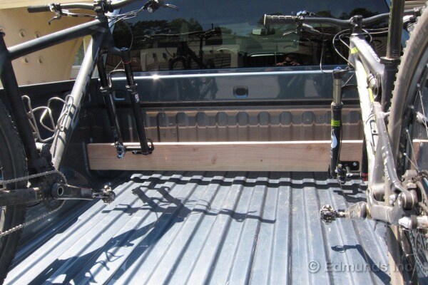

I can't link a decent picture of the slots but they are in the front and rear of the bed. you just cut a 2-by to fit.
board goes in like this:
2014_chevrolet_silverado-1500_det_lt_429
seems easy to mount a pole holder to or drill into the top. I don't have a picture of mine so I just tried to link google images.
What length did you make your board when you did this? I want to do the same thing and I want a fairly tight fit. I'm getting between 64-65". And then I'll find a way to hold it down by using the tie downs.
no idea....the sides are a bit slanted and then you have the curve of the sides to the bed. I rough cut mine then hit the ends with a sander to get it just right. Cut the bottom corners at a 45 so I didn't have to mess with the curve. Then I painted it with some house paint I had around. It will definitely stay in there nice and tight and snug without any help with the slant of the bed sides providing compression if you cut/sand/trial and error it down to fit your truck.

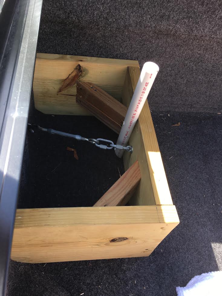

This is what i finished with... it started off the full width of the bed but i ended up cutting it down to two separate pieces. Rock solid even at highway speeds. Also gives me a nice place to store my air hose and tools when i hit the beach.
