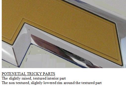

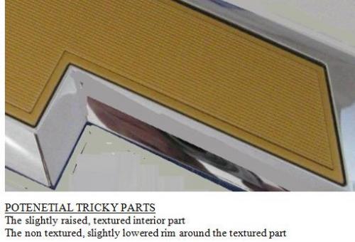

I have searched and read a lot of threads but didn't find what I needed so here we go... I want to Color match my Bowties for My Ruby Metallic LTZ... I like the http://www.americanbrotherdesigns.com/product_p/abd-1401igce.htmBowtie replacement but the price of $140 has me searching for other options... I found this Vinyl Wrap on ebay that is Color Matched http://www.ebay.com/itm/DIY-Chevy-Bowtie-Emblem-Decal-Fits-Silverado-2014-/281742449922?var=580747103047&hash=item4199289d02&vxp=mtr for $10... Seems like a DYI but after looking closely at the OEM Gold Bowties I need help/thoughts around some tricky areas.. See photo below.. Do you see any issues with the Vinyl covering the Textured portion and secondly, wrapping the lowered 1/8" to 1/4" border around the raised textured portion...

In regards to wrapping the lowered 1/8" to 1/4" border around the raised textured portion...
You are completely right about this being a tricky part. I had to redo my front wrap because I cut where the lower part begins, not where the real edge is. The second time, I pressed the edges in harder with a credit card and took my time cutting and it went fine.

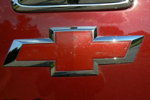

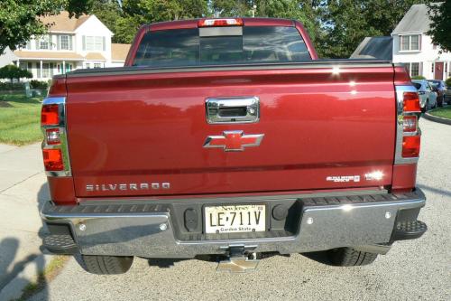

Well I did it... Took about 20 minutes total including cleaning/drying both emblems prior to installation... Bought a new exacta knife from Home Depot that worked great... I love how it came out and for $13 total and only 20 minutes, I am very Happy... The Color matched Vinyl is damn near perfect in color and was sticky so I wound up not using any additional adhesive... The hardest part was the original stick on the emblems because the vinyl was only like 1/4" wider than the emblem where the height was a full inch higher... Had to pull back off and re-align a couple of times... Turned out that the textured part of the emblems is still visible through the vinyl but isn't perfect... In other words, the textured part isn't the same across the emblem and in direct sun light, creates a different shine... If I had known prior to installation, I could have done a better job but I don't think you can get it perfect...
Added tip: Another tip I thought of is, to hold off trying to get the 1/8" lowered smooth border around the Higher textured part to look perfect until after you trim around and remove the access Vinyl... Once it's removed than you can put more pressure in this border area to get it right without putting to much stress in the tight edges/corners of the higher area...
