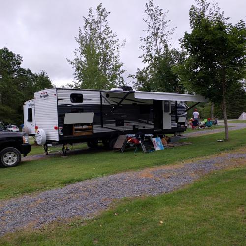

So first trip was a success. Crazy rain on our way there, really took our time. Towed well. Feel it in the hills for sure.

Looks great!!! Glad to hear all went well this w/e.
