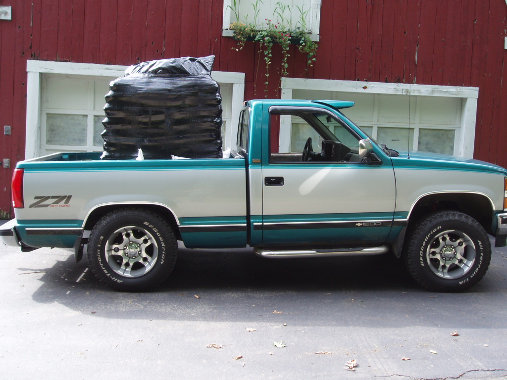

I don't even add air to my bags when towing. The bags really shine when I need to haul a 2,400 lb. pallet of coal in the back - will make the truck sit dead level ... unlike this truck here:
Obviously he needs a front hitch a cargo carrier. Equalize some of that weight.

That was the only time that truck ever had a nice ride quality ... :lol:
Actually in that pic, there's about 3k in the back. :uhoh:
