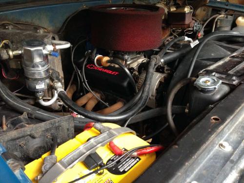

Fixed the A/C in the ol 79 K10
Decided to fix the A/C in my 1979 K10.
Cost me less than $500 to get it fixed.
I bought the following parts new and installed myself. Saved some $$$ at Rockauto
Evaporator
Accumulator
Main A/C Hose from compressor to Accumulator
Hose from condenser to accumulator - could only find at LMC
O-ring kit
Belt
just under $300
Took to local mechanic to have system evacuated and flushed.
System held a vacuum
Converted from R12 to R134A
Charged with R134A
$200
Just wanted to let people know it's not crazy expensive if you do most of the work yourself, then have it professionally charged.
Kept stock condenser.
I guess there is newer design? It was 85 today and A/C was ice cold on highway. It would warm a bit when stopped at a light but through town it seemed to cool fine.
