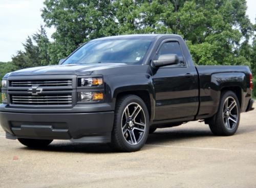

I'm fixing to purchase a 2/4 drop from rough country. Pros? Cons? Does anyone have pictures of 22s or 24s on a 2/4 drop?
Search for McGaughys suspension. I don't know much about Rough Country offerings.
My plan is to run their 2" drop spindles with height-adjustable dampers (0.5-3" drop) up front and, for the rear, 2" drop shackles, 2" drop spring packs, shortened dampers, and deleting the OEM "lift blocks" which are about 1.25" thick. Something will need to be done regarding rear bump stops and restoring most of the weight-carrying capacity; my plan is to use a Timbren product. No flip kit necessary for this scenario.
