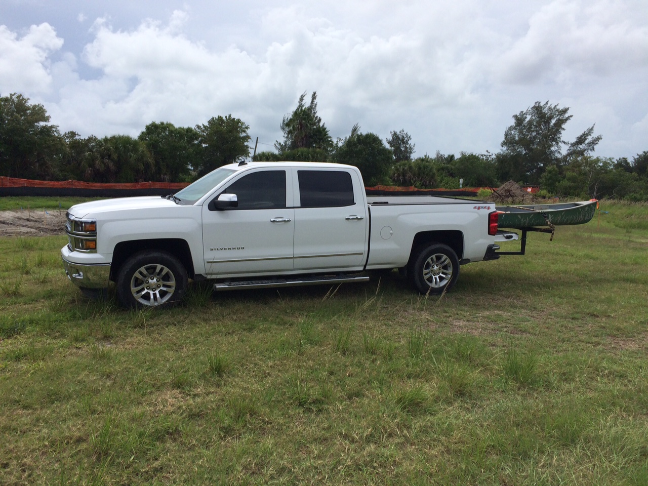

Hi guys I am looking at replacing my tires in the next few weeks and debating on what to put on the vehicle. In the past I have used Michelin LTX MS/2's on my Suburbans but I am considering a more aggressive AT look for my Silverado. I want to avoid adding a leveling kit to the vehicle just for the tires. My question is do I need to put the same size tire 265-65-18 or can a slightly larger tire me placed on a stock vehicle. My truck is a 5.3 crew cab 6.5' bed with the 3.73 max trailer package.
Another tire I was considering is the Michelin LTX AT2 or the BFG All- Terrain. I would like a slightly more aggressive look but would still like to minimize the road noise as much as possible.
