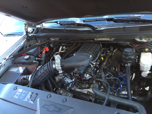

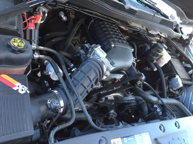

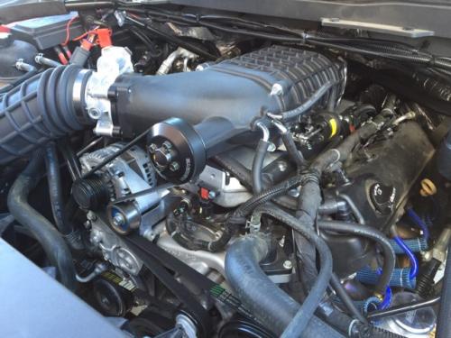

Just pulled the trigger on the Magnusons MP1900 TVS Supercharger Kit and American Racing headers. Now the suspense of waiting for everything to ship...
I have the same setup on my 14 Denali and I just love it.

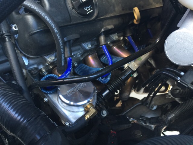

Magnuson TVS1900 Supercharger, Moroso Catch Can, Taylor 409 Race-Fit Pro Spark Plug Wires (10.4mm w/ Heat Protector Sleeves), American Racing Headers w/ high flow Cats and a BlackBear tune.... Holy Shit!!!!!
