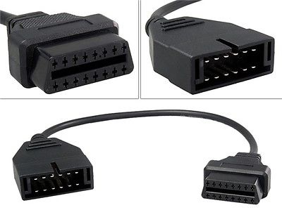

Last question i have bought dod 1 to dod 2 cable he should works right?

today i've test obd 1 to obd 2 cable and Unfortunately didn't connected with obd scanner
