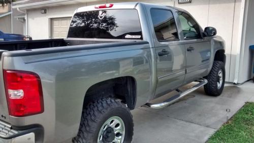

Once again I'm kind of new to this, not new to trucks, but just all the aftermarket things. So my question Is about my 2013 Silverado LS crew cab. It has the V8 4.8 4-Speed, 2-wheel drive w/over-drive transmission. It currently has a 5" Rough Country Suspension Lift with 33"X12.5" tires. When I asked the shop about re-gearing the rear he said it was not necessary as because it wasn't a big difference from my stock tires to the new ones. Now I'm wanting to add a 3" body lift and upgrade to 35"X12.5" tires. Will I need to re-gear the rear and if so, like I said I'm new to this, so there will not be any reason to do anything to the front since its not a 4-wheel drive correct. I don't use it for off-roading or mudding or anything like that. She is my daily driver and I just really enjoy lifted trucks. During the week she runs easy to and from work which might be about 8 miles round trip and kept under 40mph, weekends I go into town and usually hit around 75mph on the interstate and she settles about 2300rpm. Any help from anybody would be greatly appreciated and definitely taken into consideration when making any new decisions to my truck. Thank you all.
