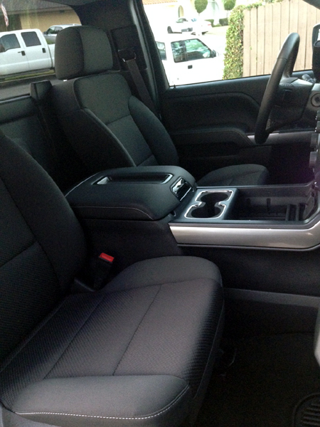

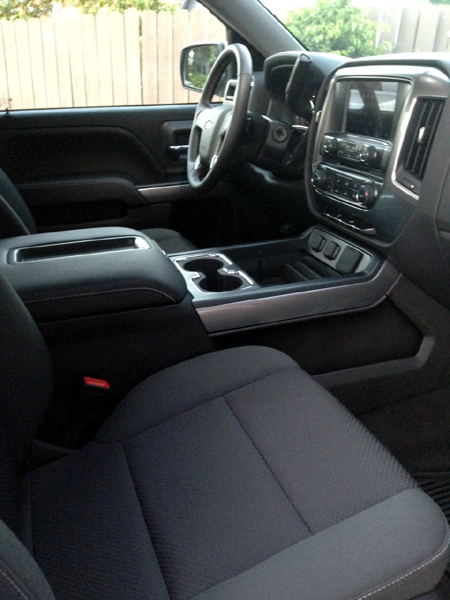

I want to see a pic of your center console, dla, I think that is my next mod.
