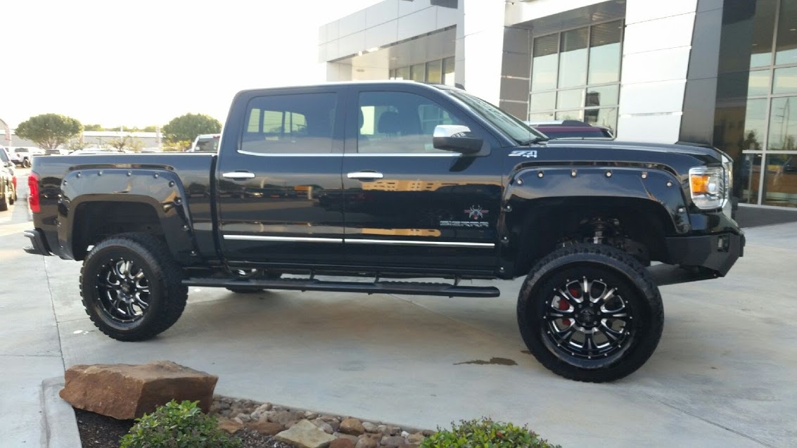

I have the Fabtech 6 inch lift on my 2015 GMC Sierra. I believe Fabtech makes a 4 inch lift as well.
The local 4 Wheel Parts seems to be pretty impressed by Fabtech even though they didn't sell or install mine.
I have the 4" Fabtech and it's great. I haven't had any issues at all. I'm running 33x12.50x20 Toyo Rt's on a 20x10 -24 offset wheel. No rubbing or trimming. That kit was $700
