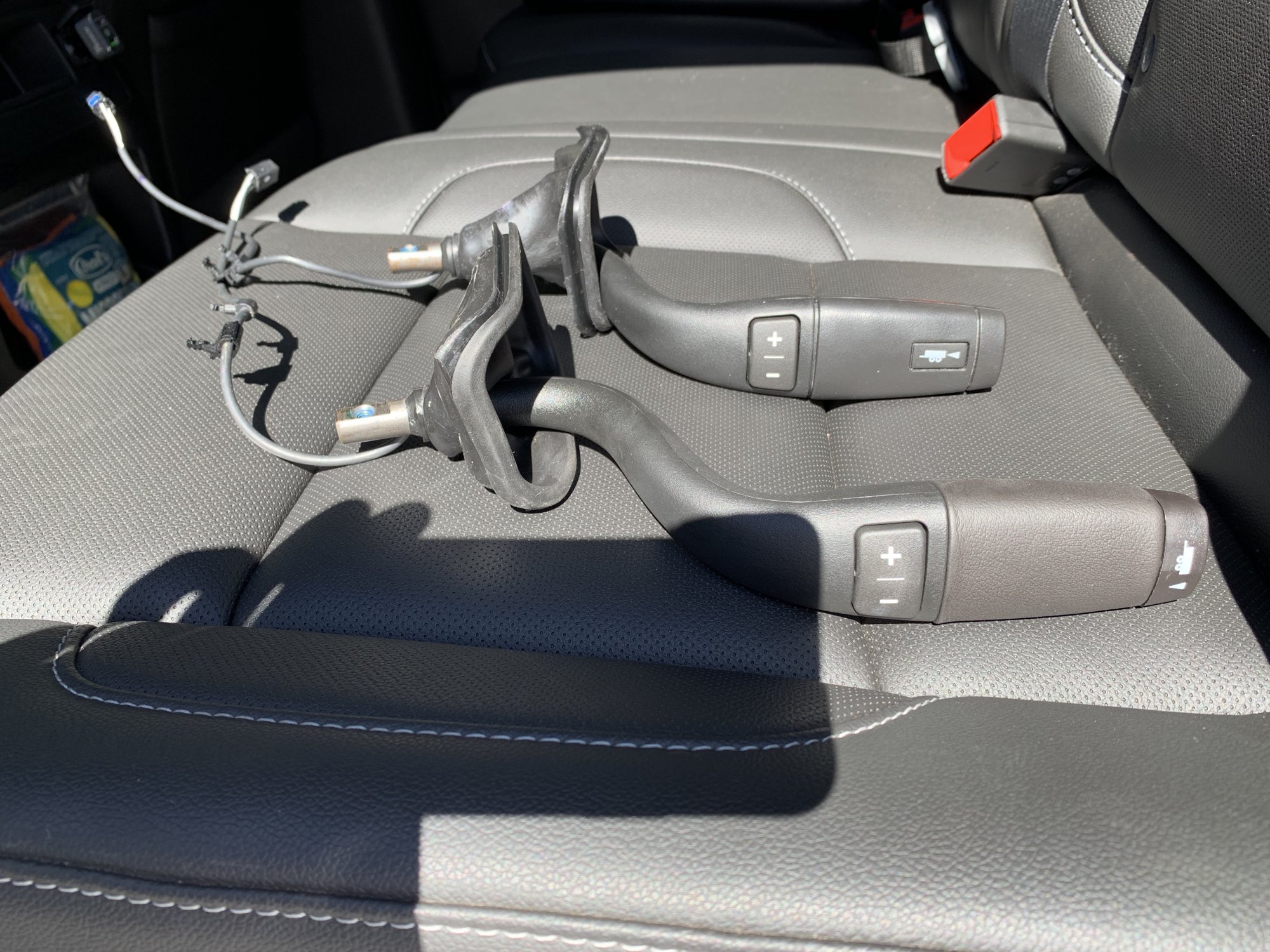

FYI - Installed leather Denali column shift lever part number 22857352. An eBay seller has it for $50 shipped.
Install was easy. Shift into L to access T30 Torx bolt. Pull knee kick panel under steering wheel to access 4 wire (2 white 2 black) connection.
This works fine with my 2018 and 8L90 transmission. L or M mode changes gears as intended and tow haul button works as well.
The leather is nice and matches my steering wheel. This should have come factory with leather wrapped wheel.
If your truck has a 4 wire connection for transmission column shift then the above part number should work.
