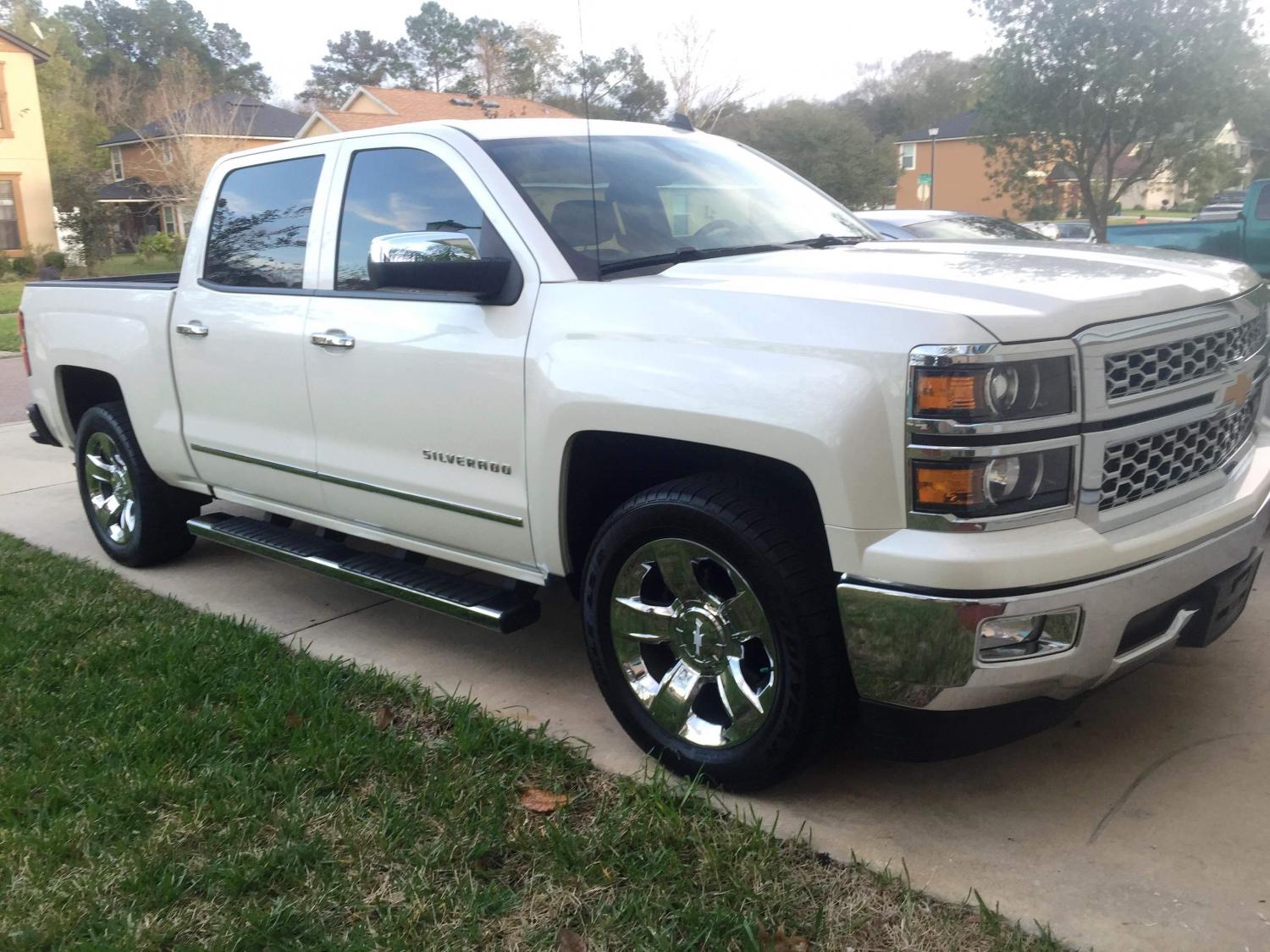

Over Christmas break, I sold my 2007 Tahoe LTZ and bought a 2014 Silverado LTZ. So far I am loving it!!
There are a few things I would love to do to it and as always, I come to the forum to ask fellow owners what their opinions are!
1. I would love to level the truck out. However, unlike most of you, I would love to bring the rear down to match the front. Can someone point me in the right direction for this?
2. I love the projector lights on this truck, BUT! I do not like how "dingy' the light color is. Do I have to buy a who new kit to get the brighter white or can I buy just new bulbs to swap this out?
3. I love the power this truck has. Seems much more responsive than my Hoe was. However, I still would like to get a Tune without breaking the bank but one that will give me a little more gas mileage. I had a diablo on my Hoe and I owned an Avalanche once before and had a blackbear tune on it. Thoughts and suggestions?
4. Would adding a K&N Air filter be sufficient enough or would I need to replace the entire CAI?
I appreciate ANY and ALL Comments!!
Attached is my new child......

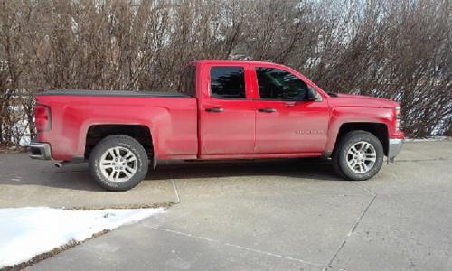

Steve, do you have any more pics of your truck from the side? I have been thinking of dropping the rear of mine also to level the truck.
This is the only one I have.
Thanks for the pic Steve.That's much better and I like it. Mine is way up there and needs to come down.
