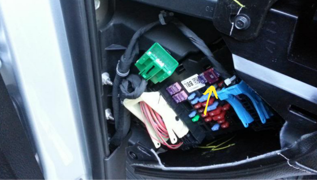

Thanks smcgillis10. I think you mean that I should move the fuse that is in position 12 to position 49. I do not see how to move the fuse. When I remove the fuse from position 12 I don't see any way to move it.
there are 3 pins in that position. you either put it to the top set or the bottom. one side is always on for accessory power and the other is switched..
let say the three pins are labeled 1 / 2 / 3.
when the fuse is on pins 1/2 the power to your 12volt sockets are switched.
and when the fuse is on pins 2/3 the power is always on.
if i need to i will take pictures of my truck to show you what i mean.
Edited by smcgillis10
My 2015 Sierra may be different for your truck. When I pull off the fuse I don't see any other way to reconnect it... BTW how do I post a picture. I would post a picture to show you want my fuse box looks like. It is slightly different than yours.
Thanks for the input.
Don
PHOTO Please
The fuse for the RAP is here on my 2014 silverado. You can see the blade that the fuse slides onto. Not sure if they changed that with the 15s can't find any information about the 15s and the rap being able to switch the fuse. They might have done away with it. f1d5bf1d9d9959048f2704684a909484.jpg
Sent from my SM-N920V using Tapatalk
That worked. The actual fuse numbers are 10 and 11. If the 50 amp fuse is in position 11 the outlet is always on if it is in position 10 it is switched with the key. Thanks for the help with this.
They mush have changed the fuse number for your trucks mine where 49 & 12
