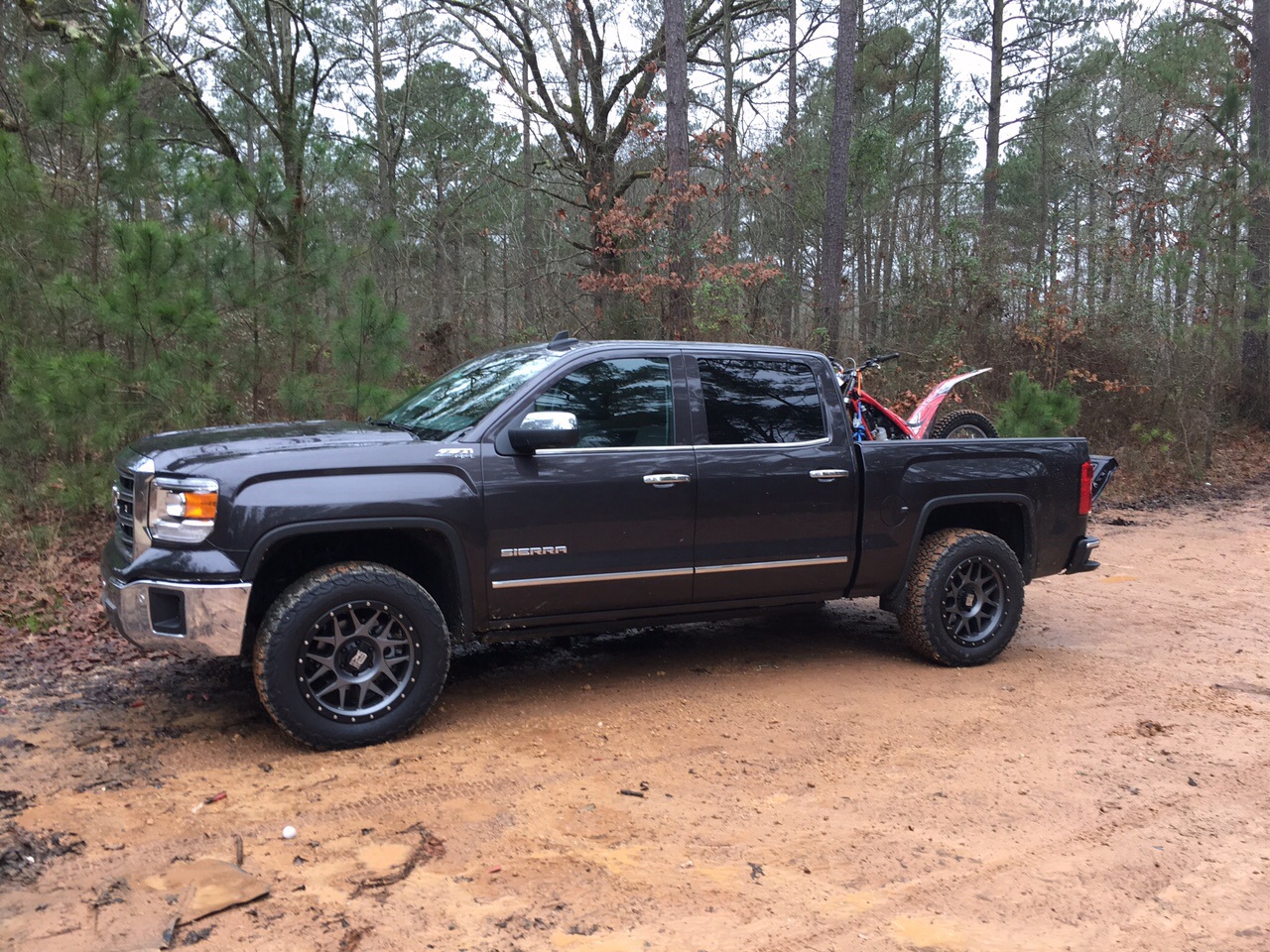

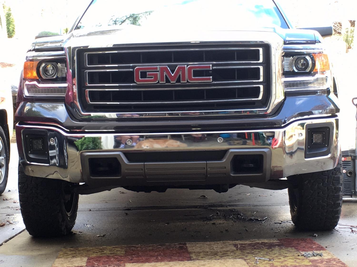

Leveled Sierra with front valance remove
Is that a level? What size tires are you running? That's perfect.
Thank you!
Yes, just a 2" Rough Country level on stock 265/70/17 Bridgestone Dueler AT's

Looks better with it off...
Any difference with MPG with it off?

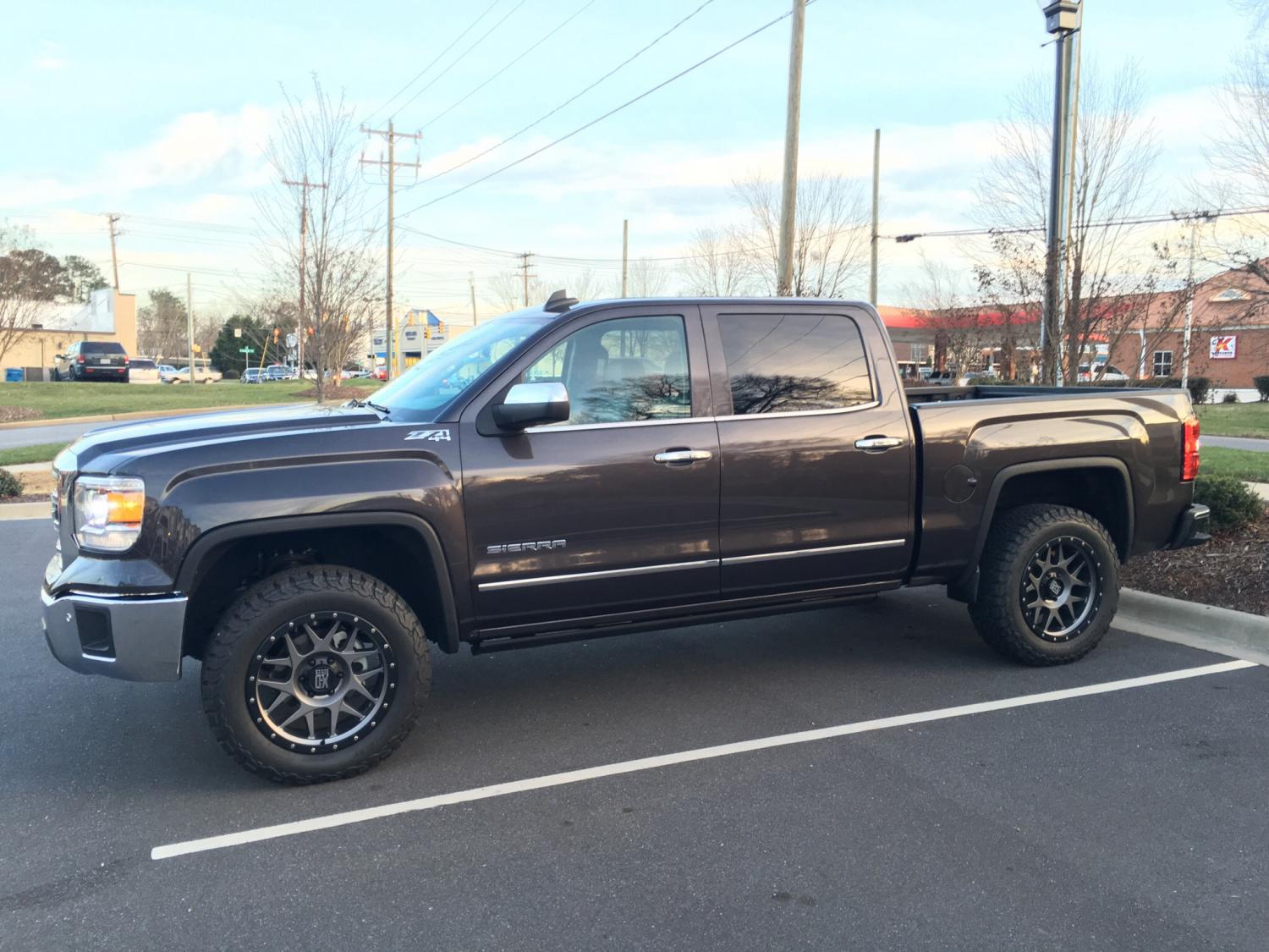

Looks good! Your tires look like they stick out past the wheel wells. Are you running spacers?
Has to be. I'm curious as well though and how thick are they? Plus, any rub issues with the added width?
I maybe lost 1mpg with the valance off. However, with the level kit and valance removed I lost 2 MPG in total at highways speeds.
Yep in that pic I was running 2 inch spacers. I recently removed them because I was tired of rubbing and they made my truck ride really bad
Looks good man. What tires are you running?
Thanks man, and I'm running 305/55/20 Nitto Trail Grapplers
At first I could barely turn [emoji23] but after some major plastic trimming and minor metal trimming they only rubbed a tad bit.
2" is quite a bit of wheel spacer. That puts your wheels at like -22 offset or thereabouts.
Oh trust me I know. It looked good, but I didn't feel like keeping them on my truck because I feel like they weren't safe
