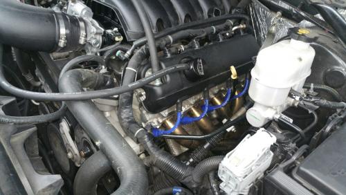

Hello Everyone. I am trying to locate the correct Taylor 10mm spark Plug Wires to use for a new Kook's Header Install. I've seen pictures of quite a few people with this combination, but I have been unable to identify the best spark plug wire set to use. The two concerns are plug wire length (9" or 12" long) and angle of the spark plug boot (180 degree straight boot or 135 degree angled boot). If I go by "stock" (w/o headers) Taylor makes a replacement wire set with 8" wires and 180 degree straight plug boots. However the headers may add issues with angle where the stock design may get too close to the headers. In a lot of the pictures I have seen it's hard to see the boot angle as the pictures are taken from above looking downward. The design of the Taylor boot makes it difficult to tell what everyone is using. On the length, I have seen both length used and the 12" ones definitely look too long as they tend to curl around loose a little. I have included a picture from the site of the fit I am looking for, just need to get the boot angle right. Just an FYI, this is for a 2014 5.3 and I am looking at the blue colored wires. Thanks in advance guys, you are the best!
I have narrowed it down to 4 spark plug wire choices:
#79603 - 9" Wires, 180 degree plug boots
#79613 - 9" Wires, 135 degree plug boots
#79605 - 12" Wires, 180 degree plug boots
#79614 - 12" Wires, 135 degree plug boots

The 9" 135 shown in the pic should work just fine. Get you some Stage 8 locking header bolts as well.

Does that look like the 135 plug boot? My eyes are getting bad, but I agree with you. What's funny is Taylor lists the 9" wires as LS car wires and the 12" wires as truck wires! I think this was for the previous motors before DI.

Yep, that's the 135 boot...in the last close up pic, you can just barely see the boot angle off on the plug...they look killer

Here is the full Monty with the all of the parts installed. Ended up going with the shorter wires with the 135 degree spark plug boots. Fits like a glove!

#79613 - 9" Wires, 135 degree plug boots are the correct Taylor wires to use if you want blue. There is also an option for red or black as well.
