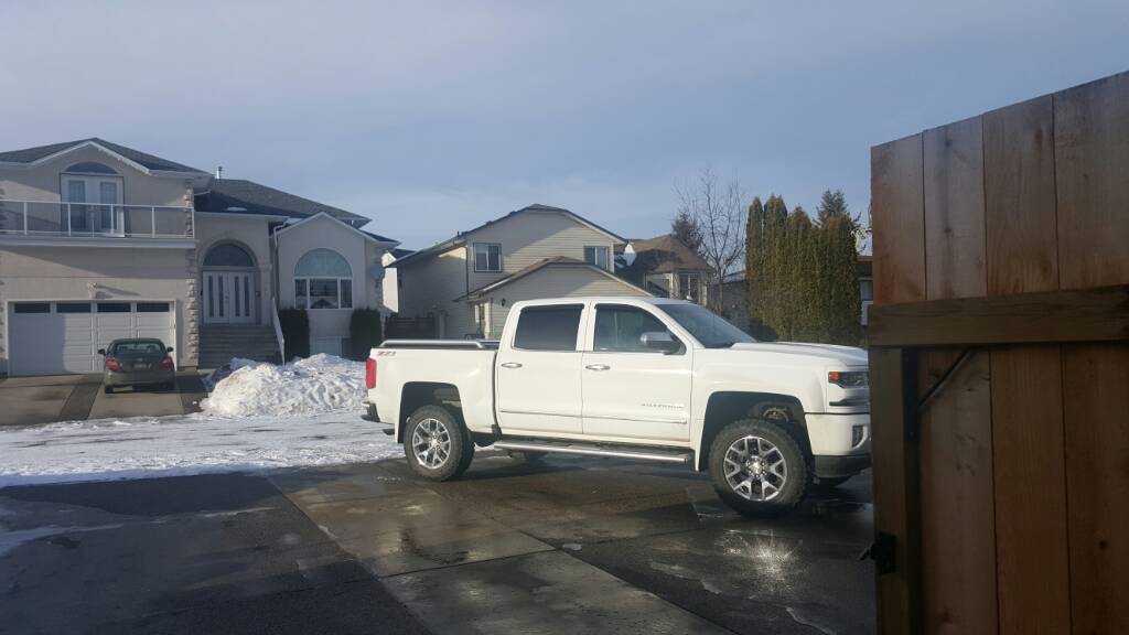

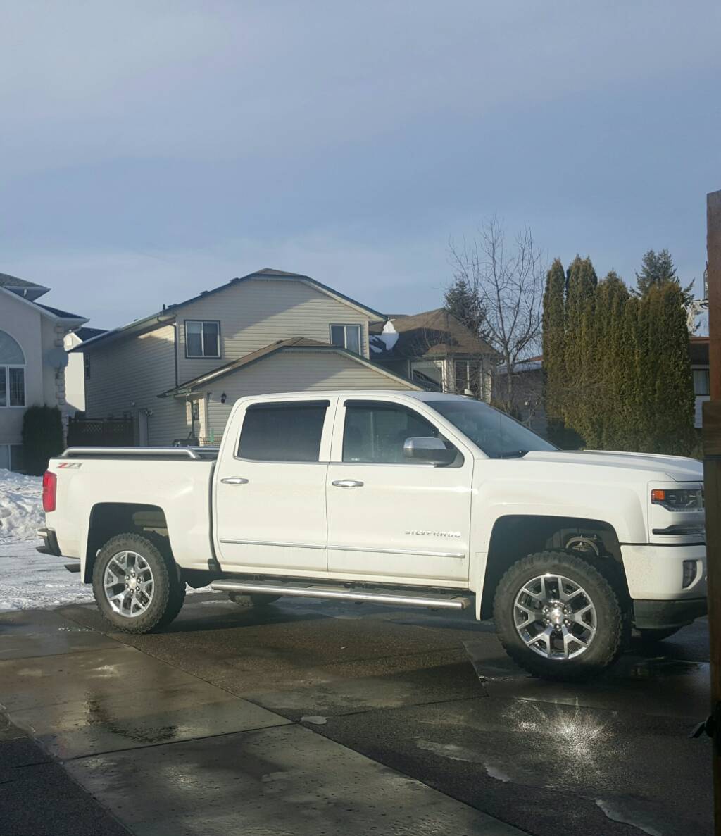

I have a 2015 with a 6in RCX lift and 35" BFG ATs on the Stock 20" High Country rims and my truck has zero vibration. I few truck ago I stopped going with aftermarket rims due to some of the imperfections from aftermarket rims and constant vibrations. Tires also play roll into this as well. OEM wheels are built to a certain spec and are generally high quality rims that will always balance out.
