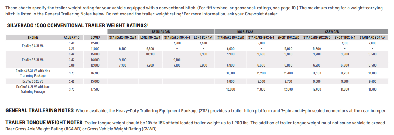

I think the big problem is payload. I don't know the exact payload for your truck, but you can look at your door sticker. You sitting in the truck + any passengers + gear + vet box + trailer tongue weight.
With a 200 lb. man and a 1000 lb. vet box with nothing else in the truck you are sitting at 1200 lbs. of payload not including the trailer tongue weight. I think tongue weight is 10% of trailer weight, so on your 6000 lb. trailer that is 600 lbs. That puts you at 1800 lbs. Payload on my 2015 Denali is 1393 I think my door sticker says, so I couldn't safely and legally do it with my truck. I know yours is higher with a Z71. Upgrades to the truck are definitely needed. Even if you just squeak under the payload limit it will not be fun to drive.
I'm not a payload and trailer expert so if my calculations are wrong let me know so we can all learn something. I don't know if springs or airbags are the answer as that is out of my realm.
Why can't the box be moved to another truck?
I could be swapped but if I changed trucks I would probably go to a longer bed and a longer box. Regardless, I'm not up for trading trucks right now. I'll just have to find a smaller trailer if it can't handle the load
I agree trailer weight is probably not the issue (unless you have the 3.08 rear end), but payload will be because of the box. I suggest you load the truck as you normally do and go weigh it on a CAT scale (any major truck stop will have one). You should get separate weights for each axle. Then you will know where you really are now.
