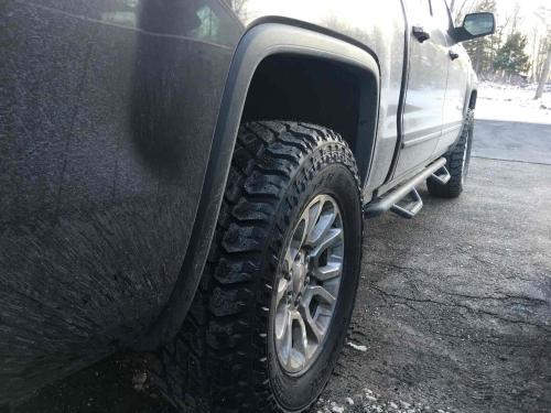

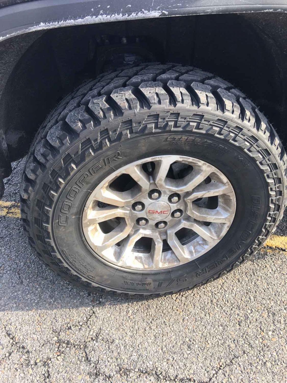

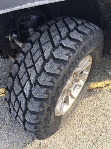

I wanted to help people out who are looking for tire options. I searched forums, asked questions, the whole 9. But not many people are running 295/70R18 on these new trucks(at least not on the forums). So I really was only able to go by a couple guys and my own measurements. Well I took the gamble today it worked out great! I researched for a while what the smallest diameter tire in a 295/70 would be but while still keeping the aggressiveness I wanted. I went with the Cooper S/T Maxx. The sidewall actually says 34x11.5. My truck only has a 2" RC level. The guys in the tire shop mounted one up for me first and we checked for rubbing. I'm not rubbing any components at full lock (sway bar, UCA). I get very very slight rub on the inner carpeted liner. It's so little I will probably not even tie back. I wouldn't be surprised if there was a little more rubbing with an M/T tread like a Trail Grappler or STT Pro since the overall diameter is a little larger.
So to sum up: 2015 Sierra Z71 with a 2" RC on stock z71 18" wheels - 295/70 DO fit nicely with very MINIMAL rubbing on carpeted liner (seems to be full lock in reverse).
Pictures to follow shortly! :)
Great to know Frank!! And thanks for the pics....tires look really good!! I've had the ATP's now for about 18k miles with zero issues. Will try the S/T maxx's next for sure.
