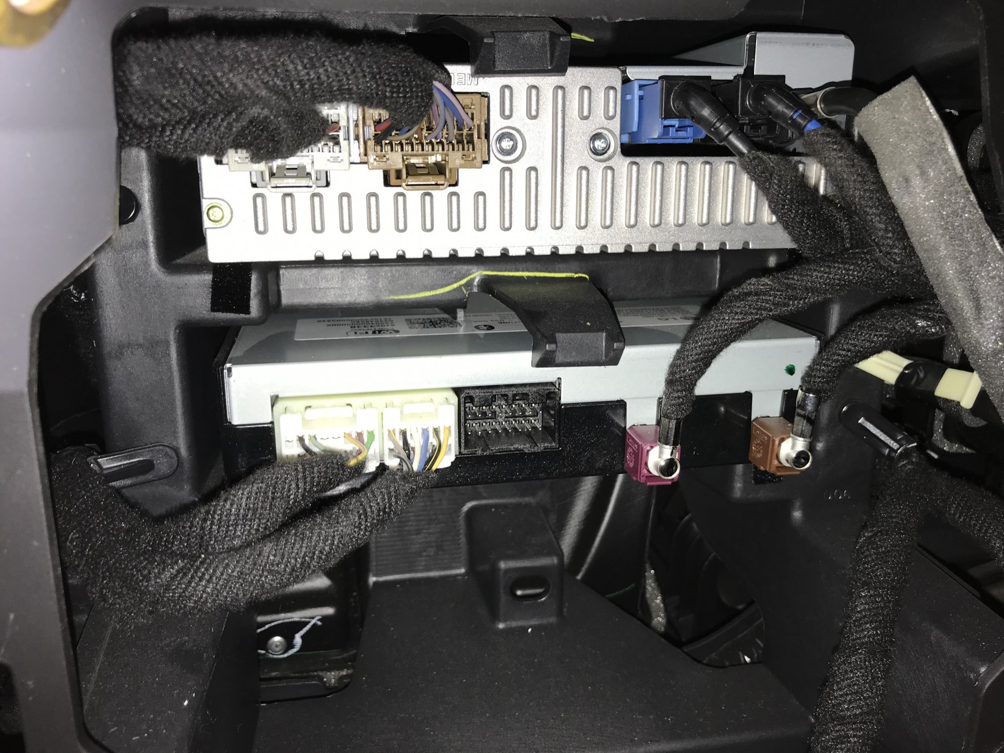

Hey guys- this is my first post on this forum. So after doing tons of research I had no luck on installing a backup cam to my IOB. But I found this (link attached below), and ordered it. A little pricey but not bad for factory parts. Install was an absolute breeze! They give you a tailgate handle with the camera, and the new module to place behind the screen. If you have any questions feel free to email me.

Dylinwagner, did you have XM or did it give you xm radio I see you have the antenna port
