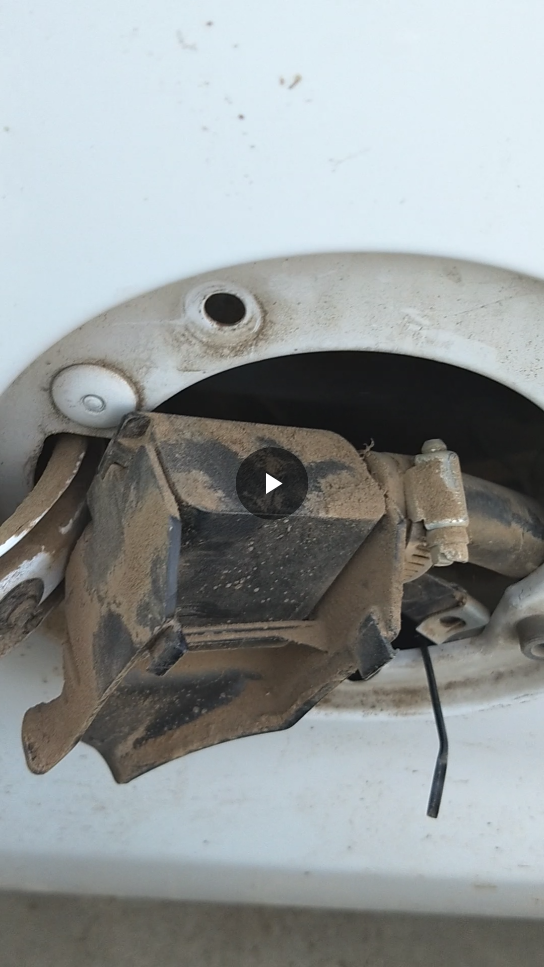

I only have the issue at one station. The fix there was to hold the handle sideways with the hose pointing towards the rear tire. Frustrating until I figured out this trick.
I fixed mine today check your vent hose that runs from the filler neck to the tank and see if it has a kink in it. If it does that's the problem, I cut 2" off of the hose and straightened it and reinstalled and that fixed it I put 24 gallons of fuel in about 2-3 min. Fixed!!

I got my truck back from the dealer for this issues and the paperwork/ the service writer stated that their was a debris stuck inside the hose I guess causing the issue. I don't believe that but as long as the tech fixed the issue is all I care. Pumped gas and no issues yet.

It has improved but it still happens but not a lot before the tech did what they did. I went back for the driver seat moving around, they shimmed it or something and also complained about the gas tank issue. My service writer stated they are going to replace the gas tank so it's on order right now. They will call me when the part comes in and replaced the gas tank from what he explained to me.

Check the vent hose for a kink in it...It won't take much to disrupt the air flow to vent the tank properly. Not sure why the dealers are relpacing the fuel tank.

Yes make sure to check the hose changing the tank won't fix the problem or atleast it didn't with mine. Theye "removed the tank and blew all the vent hoses out. Problem solved.

Dropped of my truck today, I check with the service writer and he stated yes they are replacing the gas tank. I wish I knew more details what's wrong with the gas tank but the tech is installing a new gas tank for sure. Coming from the service writer.
With mine, if I put the nozzle all the way in, it would shutoff every $1.50-$2.00, on most pumps. I have been dealing with it, just have to remember to put it all the way in and pull it back out about 1/2".

Not sure if I updated but my dealership replaced my fuel tank last tear and fixed all my issues. No more pump trigger going off now
