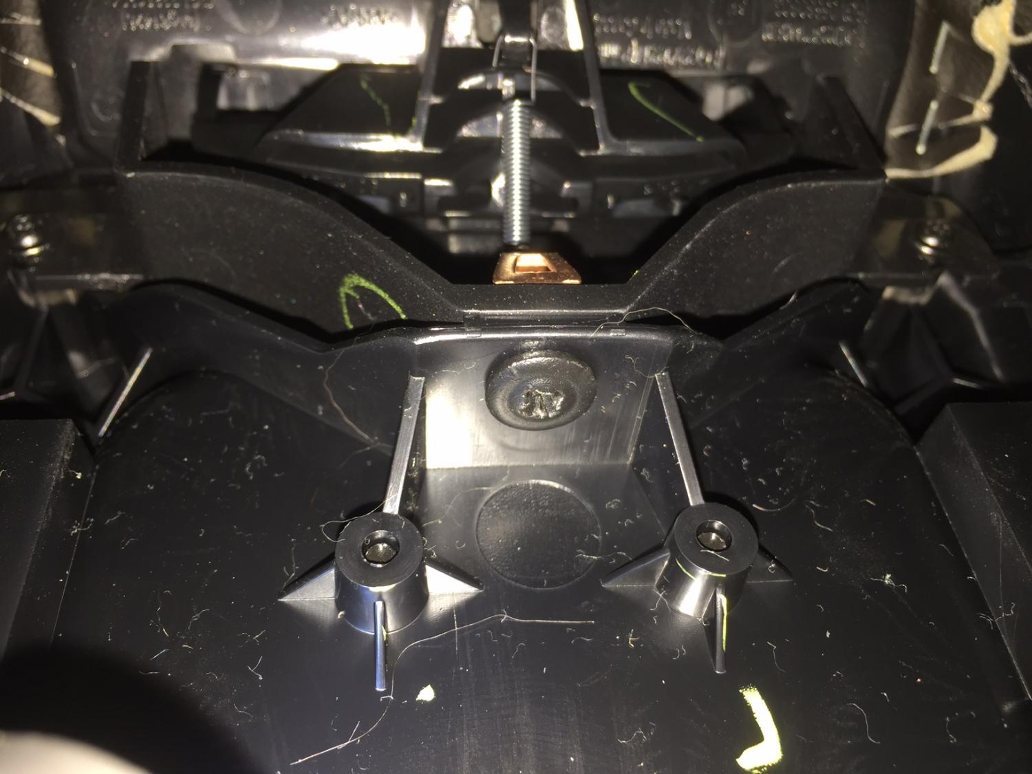

I decided I liked the look of the chrome latch instead of the black that goes on the floor console so I ordered one (22861304). The problem is that when I went to remove the old latch assembly I couldn't figure out how to remove the console lid lining and there was no information to be found anywhere. If anyone is interested, here are some photos of the console lid and latch.

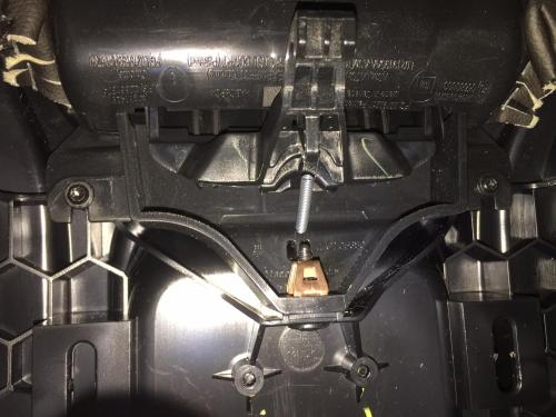

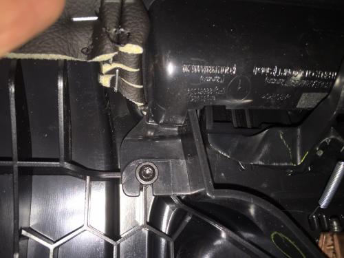

Two Torx T15 screws on either side of the latch assembly and a single Phillips screw in the middle.

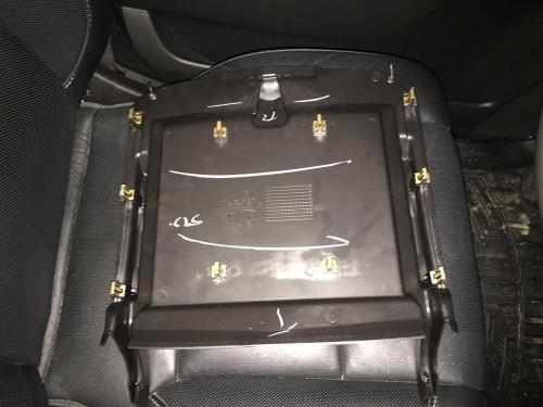

You can also see the underside of the floor console lid now that the trim liner piece has been removed.
The trim piece has 10 of the friction clips that have to be pried out. I used the plastic car trim removers to do that with so that there was no damage to the console lid or trim piece.

Yes, very simple. Carefully pry the inside plastic from the lid. Then you will see 3 screws holding the latch on the lid. One is Phillips head, 2 are T15 Torx. Remove the old latch, then screw the new latch on. After that, snap the plastic cover back on, being careful of the wire harness for the cell phone charger.
