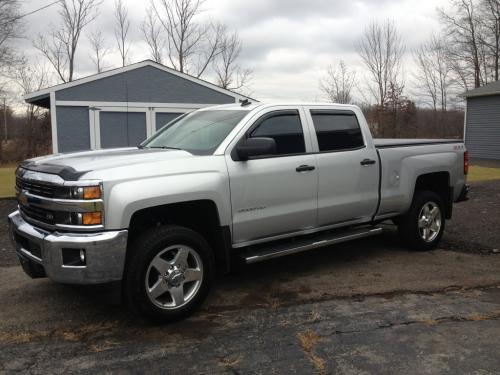

Hi everybody,
I'm new here. I just bought a new leftover 2015 Chevy Silverado 2500 LT Crew. 45 miles on it. I had the DL8 mirrors with just power adjusting and heated. I bought 2015 Chevy Silverado 2500 DL3 mirrors that only had a few hundred miles on them. They have power adjusting and heated, integrated signals and power folding along with puddle lamps. The guy even give me the wiring harness that come with them. I had to purchase the switch separate. Part # 23154702. The problem is, the turn signals work fine in the mirrors, but NO power fold and the mirror only adjusts up and down on the drivers side only. NO adjusting on passenger side what so ever. I noticed puddle lights work, not real bright, but they do come on. I took the truck to the dealer today and they said I'm pretty much SOL! Any suggestions would be greatly appreciated. Thanks again...
