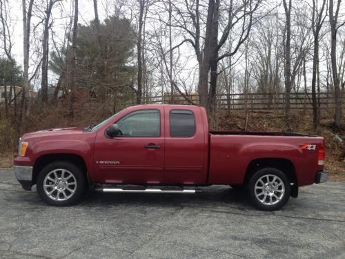

So, i have been pulling my hair out with my recently acquired 07 Sierra. It came with Wranglers, stock size. It has a very distinguishable whirring/helicopter rotor sound once i reach 35 mph or higher, only on what seems to be the driver side front.I was convinced that it was a wheel bearing because the sound would change tone when i went over humps in the road, indicating to me that the bearing was having pressure let off slightly causing sound change.
