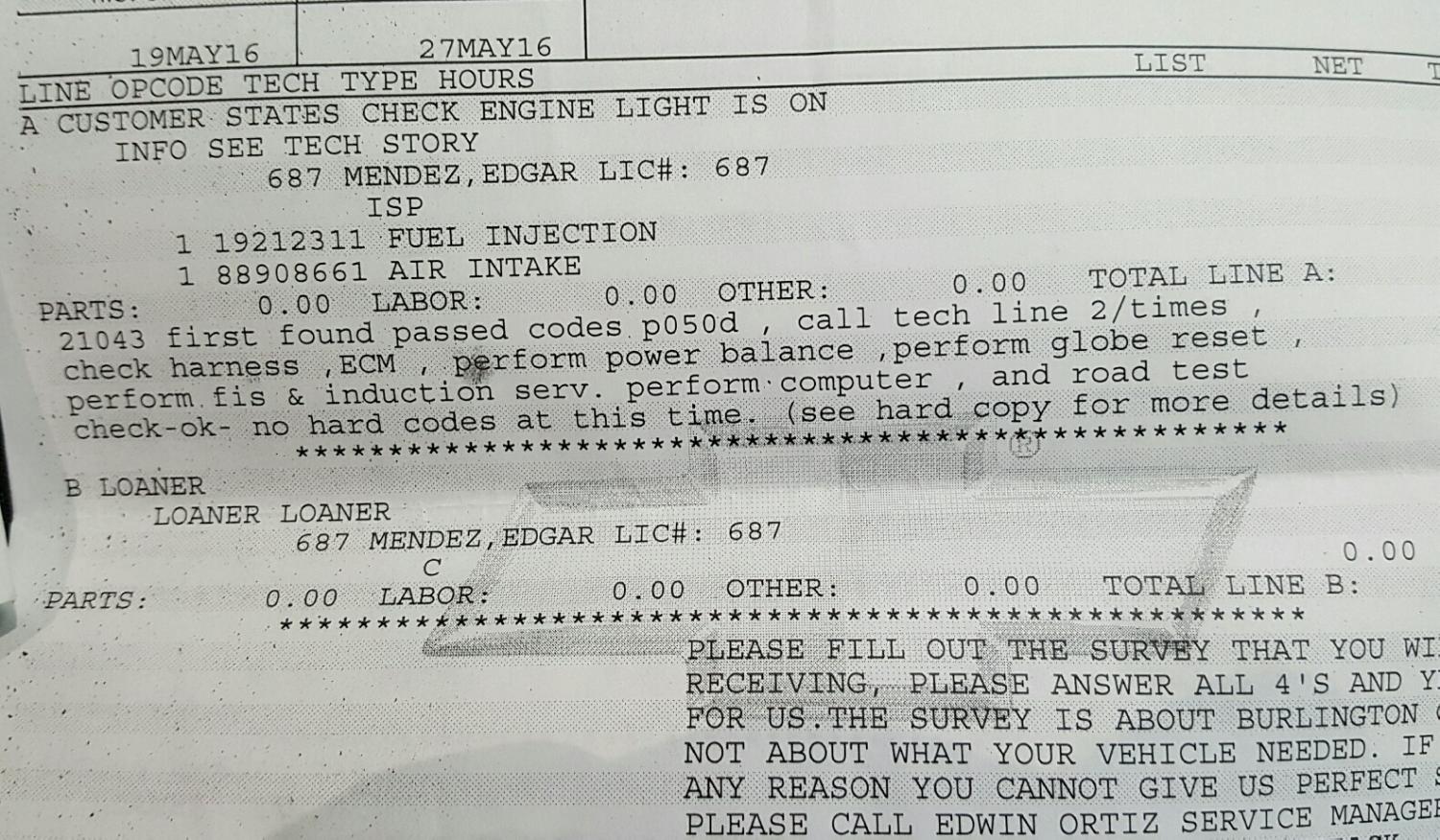

Just to update, they never did replace the injectors. They did a global recalibration on the ecu and did valve/injector and intake cleaning. It's been three weeks and truck seams to be running great again.
Got any PIT or service bulletin referring to this?? Work order info? Must be nice to get the vales cleaned for free
Service manager told me they could not replace the injectors without GM approval. This is the route they were told to go I guess. Either way it seams to have worked.
doesn't look like they did much other than resetting the computer. If they end up touching the injectors at all, they would have to replace the gaskets, and that may have fixed it. Not the ecu reset.
