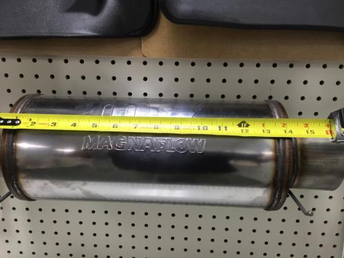

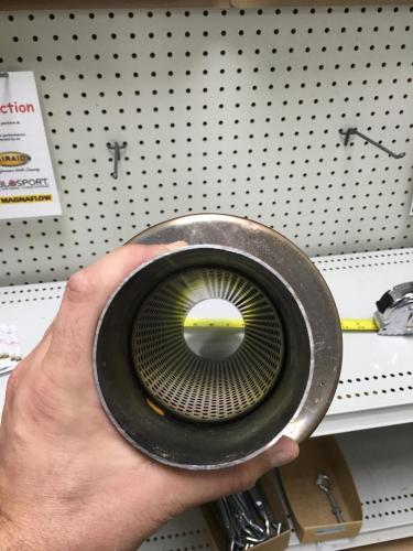

If you are looking for a 3.5" straight through and don't mind it being a little louder, I have Magnaflow 14161 Race Muffler on the shelf in my store. I used it for about 10 miles on my truck to see if it changed the tone of the dual out system. Still looks brand new and would ship in its original box with paperwork. Retail is $156. I will take $110 plus tax and shipping. (that's what I have into it)
PM me if interested. Not looking to make any money just trying to help out.
-Eli
