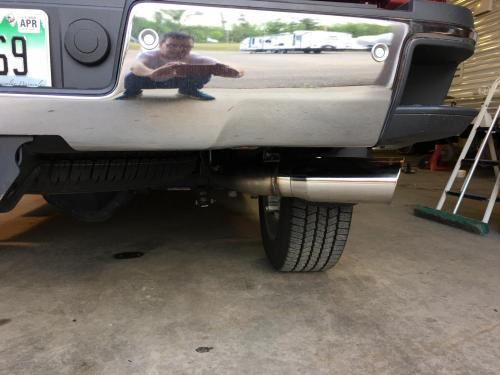

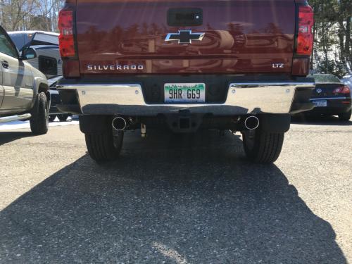

I just went through this so hopefully I can add some info here. I am going to cut and paste my experiences from another thread on a different site.
Hi Guys, (this thread is to provide pictures of a cat-back on a new HD. There is almost nothing on the interweb currently)
Yesterday I finished installing a new "large performance" cat-back from Magnaflow. I had a 19026 single side exit system on order but after SEARCHING for pics of the tip placement I had some concerns. I really do not like exhaust tips sticking out further than the body lines. I changed my order to the 19027 dual rear exit system. It took some fiddling to get the pipes and tips aligned perfectly but I am pretty happy with the way it turned out. It is 3.5" to the muffler and dual 3" out with 4" tips. It sounds very nice except for an excessive interior drone at 1800 RPM. I am hoping that may get better after break in. If it doesn't, I may add a 12" x 6" round Magnaflow muffler in front of the existing muffler.
Last week I installed a Magnaflow 6" round x 14" long muffler in front of the existing muffler on my truck. It helped some with the drone but not enough for me. My stock exhaust went back on and I put the Magnaflow system on my 2015 shop truck. This truck is a regular cab long bed. Interestingly enough there is ZERO drone from the system on this truck and I did not put the extra muffler in. I am guessing it is because the muffler winds up under the bed instead of under the cab. I wish I could have gotten it to sound this way on my personal truck. Either way, it sounds fantastic and is very nice quality as well.
-Eli

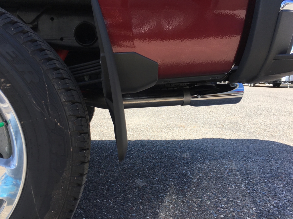

Update...I'm kinda pissed now...the exhaust was touching the rear left mud flap and the heat shield for the rear tire. So it's back in the box and going for a return.

Hi Guys,
Here is Magnaflows other cat back system for the newer 6.0L HDs. Part number 19026. I installed it yesterday. This one is quieter inside my crew cab than the 19027 system was. It is also slightly quieter outside the truck but still has a nice deep tone. Fit and finish are excellent.
-Eli
