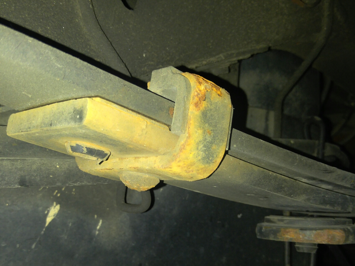

Not the overload spring pads or the pads at the center of the springs. There are plastic pads between the main spring and the next leaf down. Look at the clamps at the end of the 2nd spring. There is a small plastic pad between them at these clamps. It takes very little articulation or other movement for these pads to slide. Even just the small amount of axle wrap when stopping or accelerating from a stop can cause the pad to slide.

The pads are probably there, but what typically happens is dirt makes it's way in between the surface of the pad and the upper leaf. The extra friction causes the pad to creak/squeak/pop as it stick-slips against the leaf.
First, pressure wash each pad. After they dry off, you can try lubricating them if you'd like. I would use either a dry graphite spray lube or a Teflon (PTFE) spray. I think I used Super Lube spray (AC Delco #12346241 / Super Lube 31110).

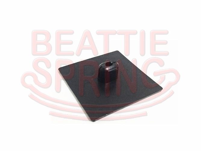

Here's a picture of the polyurethane square pads (2.5x2.5"):
Installing leaf spring pads:
http://www.dieseltruckresource.com/forums/1st-gen-ram-all-topics-93/installing-polyurethane-spring-tip-inserts-224332/
