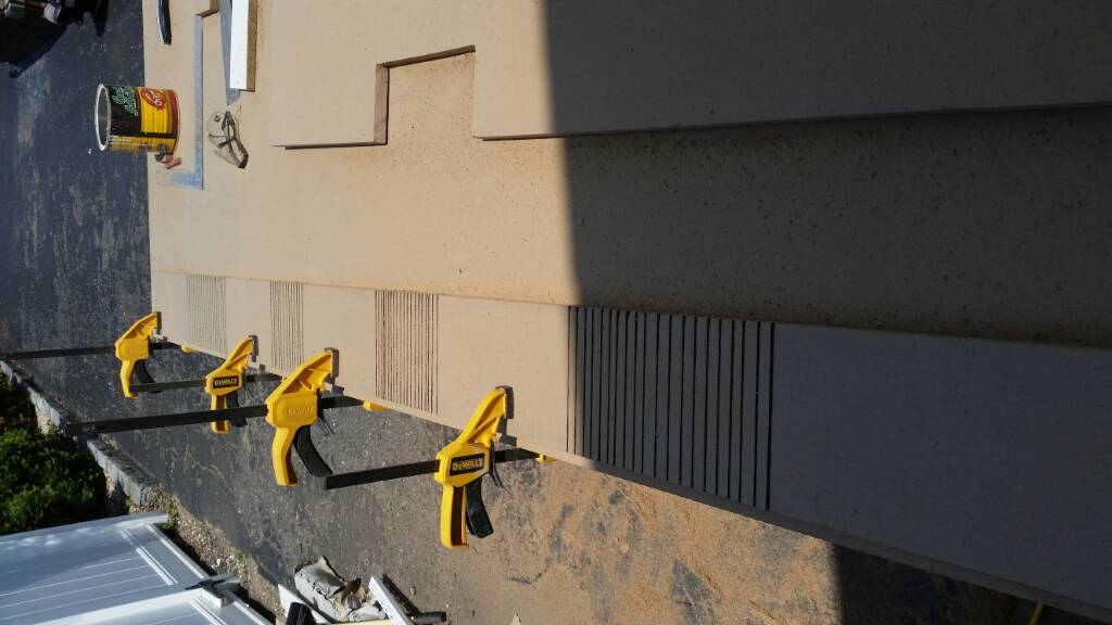

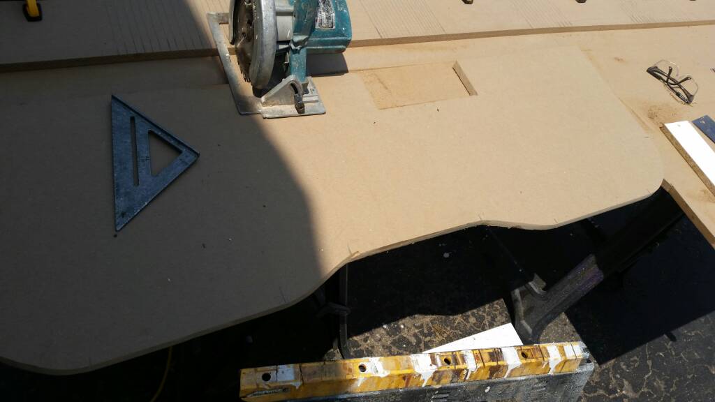

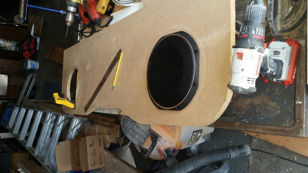

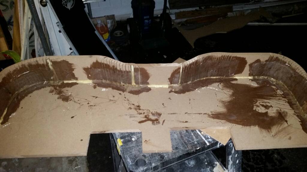

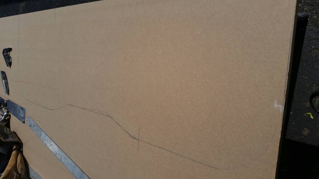

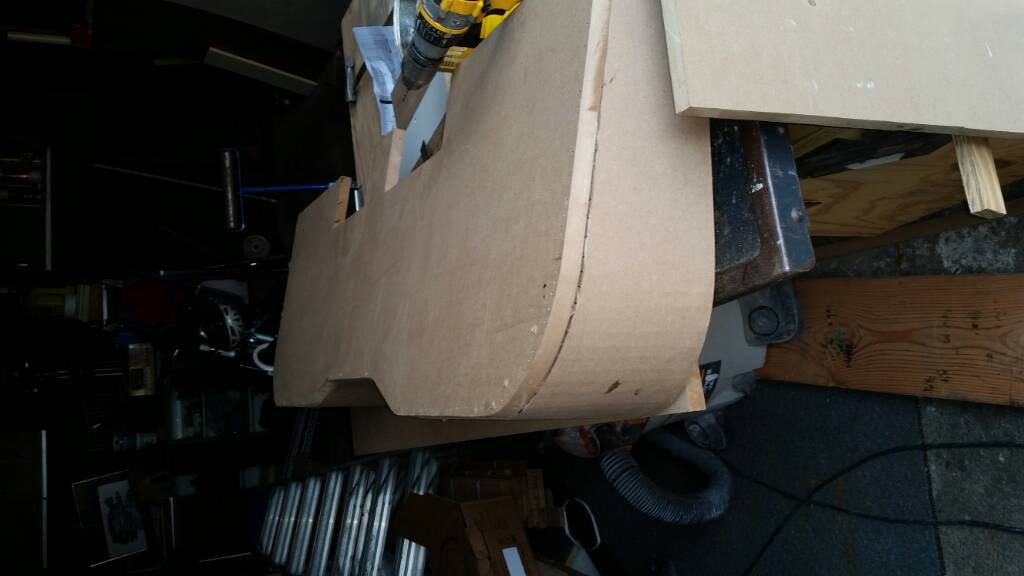

After a while of researching and looking upnideas i decided to build my box. Couldnt get what i wanted so decided to give it a try. Almost done.post-152173-146448694458_thumb.jpgpost-152173-146448695238_thumb.jpgpost-152173-146448696688_thumb.jpgpost-152173-146448697883_thumb.jpgpost-152173-146448698518_thumb.jpgpost-152173-146448698985_thumb.jpg

Nice job kerfing the corners this will look so much better than 90° angles.
I was disappointed there is nothing out there with a single 10" in one half and storage in the other, that is what I plan to build.
Thanks, Take ur time on the kerfs, should have grouped them.close together. Also my neighbor said i should have wet it and bent it as opposed to kerfing.
Sent from my SM-G900P using Tapatalk
On solid wood, sure. On MDF, not a chance.

Ran into a fitmint issue, because box was deep i hit the hump towards the back. Little cutting and glueing all done. One glue dries and i clean it up i will test fit again.ce3d9c06e819223c842253468739db69.jpg
