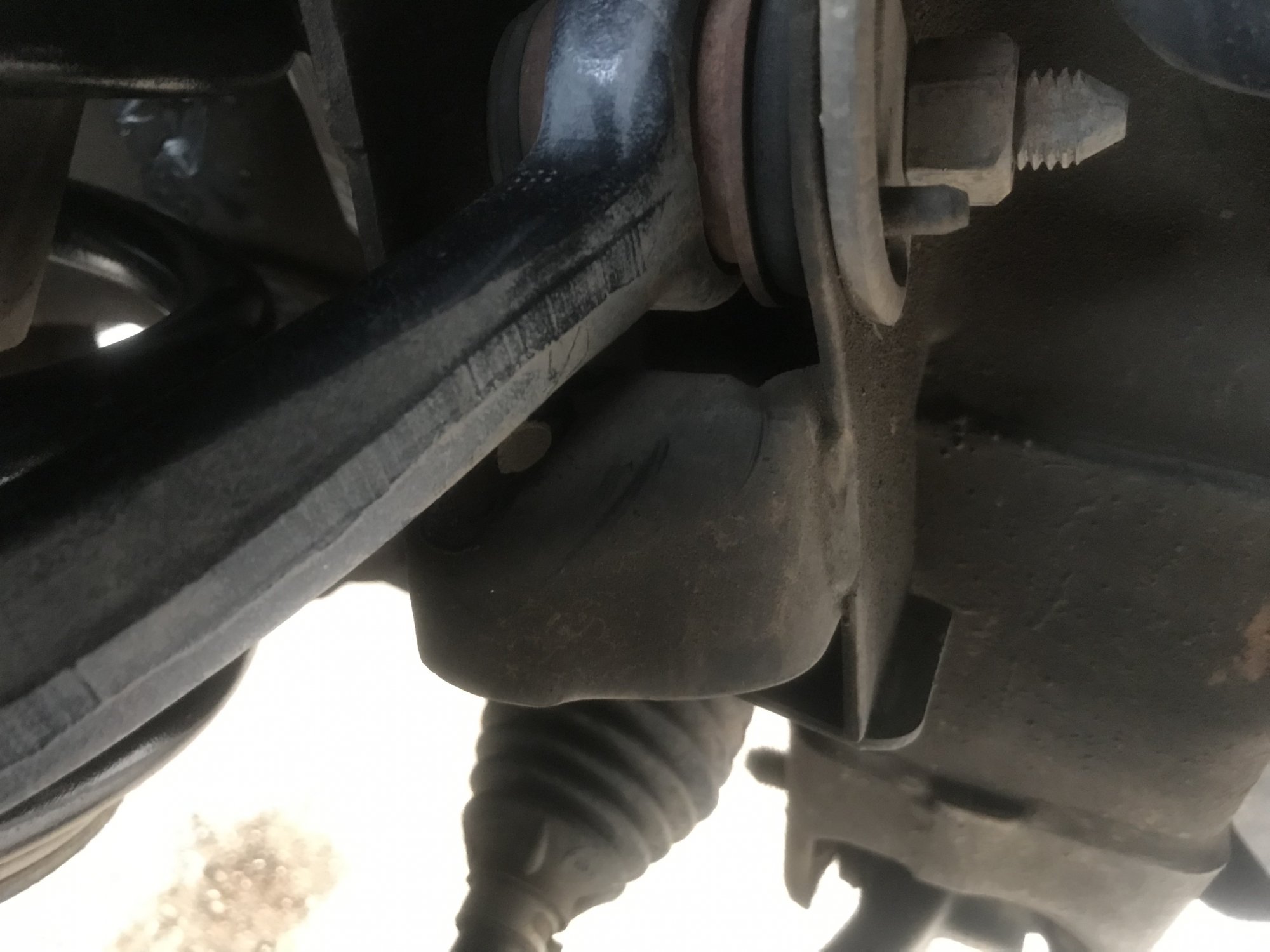

The problem with any leveling kit is the the down travel. The higher you go the less down travel your suspension has. This picture is with a 2.5" leveling kit. I had a 3" kit on for awhile and the constant bottoming out ruined the drive quality. With a leveling kit it pushes the upper control arm closer to the stop limiting the travel. Notice the gap between the control arm and stop. Stock is always better, but with a 2.5" you shouldn't have much trouble.
Just get a 2” level from Rough Country and call it a day. It won’t effect the ride quality one bit and suspension geometry will pretty much stay the same. Stop over thinking it.
