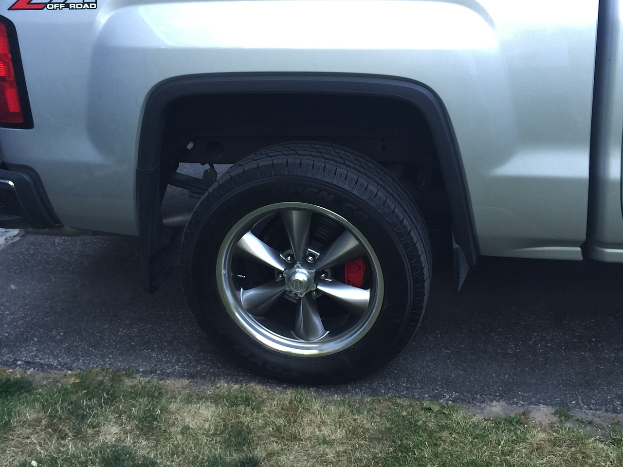

back to the old school look...

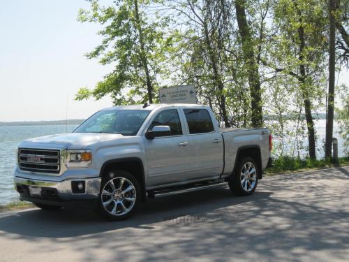

...had GM 22"s on factory chromes, but was never really happy with the look. So I went with what I knew I'd love, Torque Thrusts on Toyo 275/55/20.
Any Canadians here interested in the 22"s, pm me...
Always loved the look of the Torque Thrust wheels. Looks good on your truck!
Thanks!
Looking good. I had Torque Thrust II's on many of my previous Fbodys. Always a clean look.
Beauty. I tried PM'ing you about the 22's but not sure if it worked.
Sent from my LG-H812 using Tapatalk
yes, I replied. Rims are available, call me at 705-241-9737
