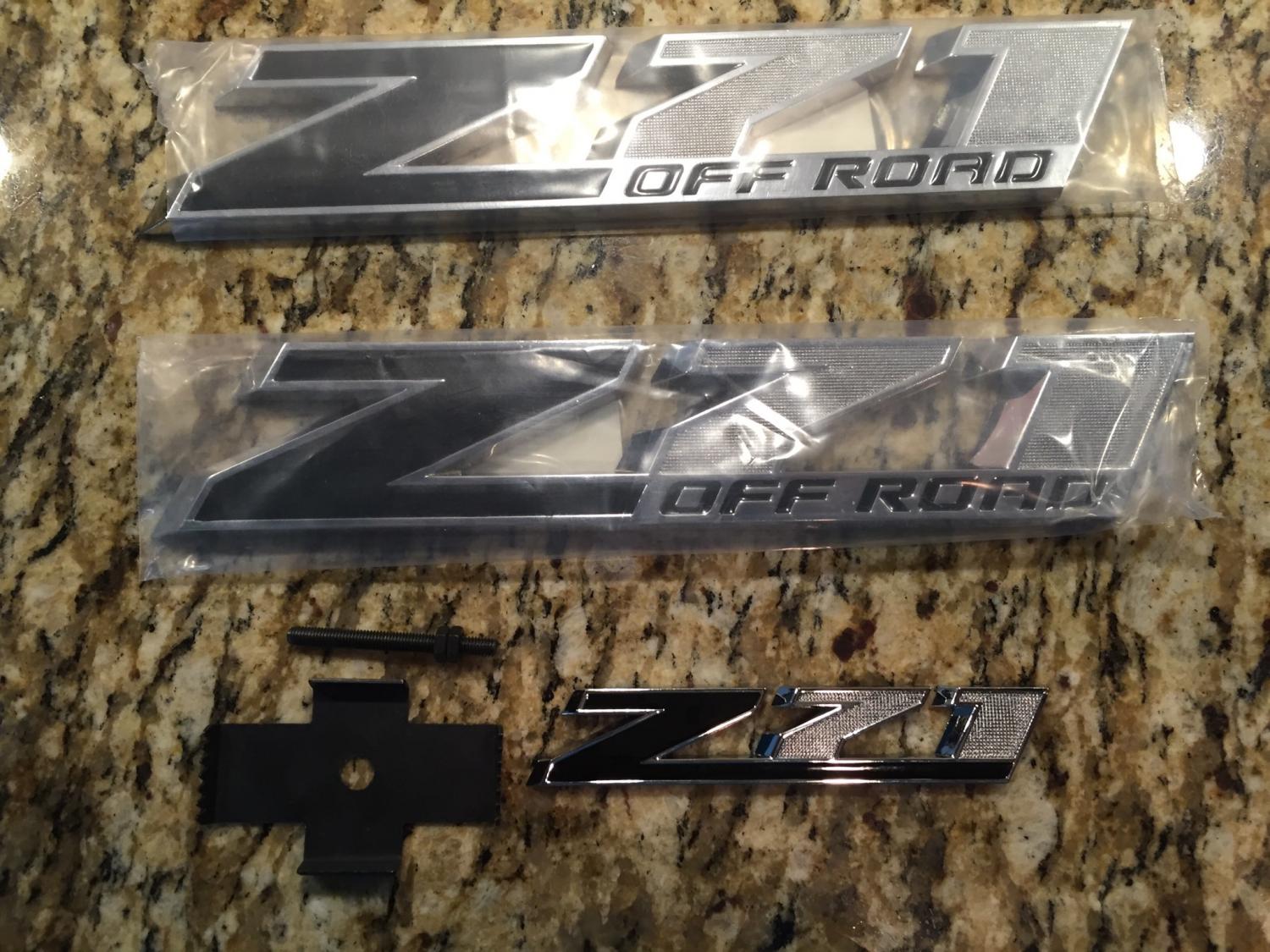

I just picked up some black and Chrome Z71 emblems and now I am not sure how the grille one attaches. I am going to pull the grill tomorrow but I wondered if anyone has removed/replaced one on a 16
It came with an attachment piece but it may not apply to this year. I am thinking I may have to go with 3M tape
OE badge is the same 2014-2016. The new one you got (hopefully) should have double sided tape as the OE badge is double side tape right to that spot on the grille.
New grille one does not have the tape already. It came with the mount and screw you see there. I think you are right though. However, I did feel what felt like two small tabs sticking through the grille like the badge was pinned on.
Yep, same one.
It looks like a retro fit piece. Not sure OEM install is the same. At least, not any more
Look for insight so I only have to remove the grille once tomorrow with all the pieces and info in hand.
The one on my '14 is just double sided tape with a couple little pegs to help align it so I would assume it's the same for the '16. Personally I would put some good double sided tape to attach it. I think that setup is more or less to be universal.
Pins for alignment makes sense. That eases my mind on the pins... Good to hear. I have the 3M tape ready.

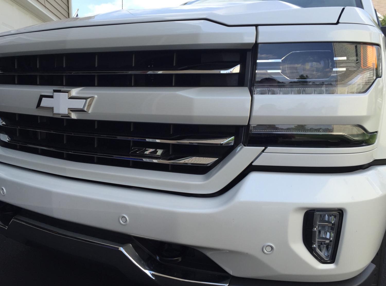

Grille removed by pulling 14 plastic rivets and 4-10mm bolts then a couple of firm pulls.
Peeling the OEM after light fishing line cutting to reveal 3M tape and locations pins.
Final product
Final product
Looks good.
I know black looks good as an accent on a white truck. But, if that was my truck I would have done it in white because the Z easily gets lost in the grille.
I thought about color matching mine but I don't mind the red and white to give it at least some contrast like the chrome does. I do want to change the bumpers to black chrome though so it's not so much chrome. When I was younger I was in my chrome phase where I wanted everything chrome. Now I still like chrome but not too much.
I hear what you are saying but...
It looks a lot better in person as the chrome surround catches light. Heck it even looks better in the original pictures before posted to the site
I didn't see white as an option when shopping. The rear emblems will match and the white wouldn't stand out on the bed as well as the black will
