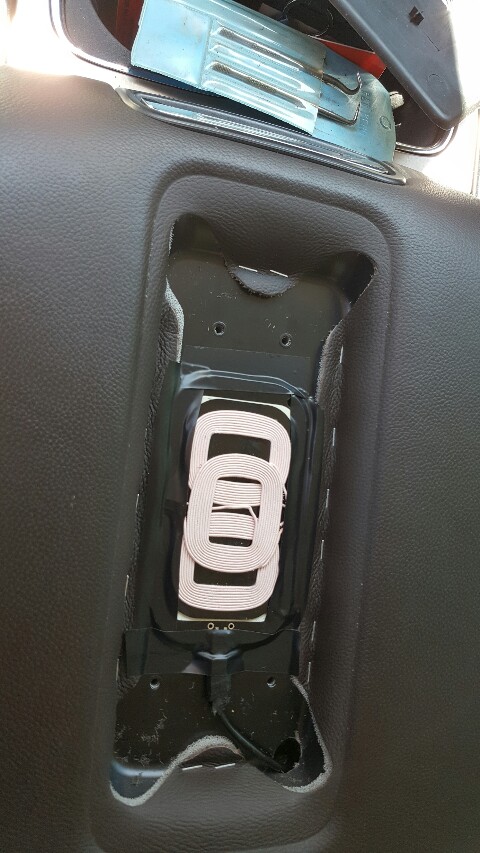

Lets look at the situation on our truck wireless charging situation.
This is a Escalade console but the Denali arm rest is the same.
3e8a4ed5c39096fff1637cf6e671cba1_zpsquz0
that little box under item 7 is the charging unit basicly in a plastic enclosed box so it can be placed during production into the armrest. So figure this is like your home charger sitting on your desk or table. BUT
NOW add item #2 which has again plastic on the top armrest pad. The plastic in the recess section again adds material between your phone AND the charge. NOW MORE
ADD in item 3 which is the cover that holds the rubber pad you see on the recess armrest. BUT THERE'S MORE!
ADD THAT item 3 the rubber PAD!!! now we have enough distance and obstructions to barely make our chargers work due to diminished charging signals!
Don't have to worry about your phone case, I don't think if you got it to fit into the recess area the charging would be dismal.
This is why those customers that have their phone fit into the recess the phone cycles on charging and dropping charging. I bet its a combination of voltage from running the power systems and slight changes due to heat or road vibration while in operation.I think this is a reasonable reason it does not work.
Now to see IF our GM engineers ever look at these forums, how about reducing the distance by removing materials and slight modification of placement of the charger unit. I can understand the module encased BUT how about making a opening in the armrest and reduction thickness of materials on the reces plastic and the rubber pad. Maybe even making another opening on the recessed plastic. Hey I'm sure GM could bench check my recommendations. Make a lot of customers happy. Also a refit of the cup and trim on the edges to allow phone to be placed with a small case.
