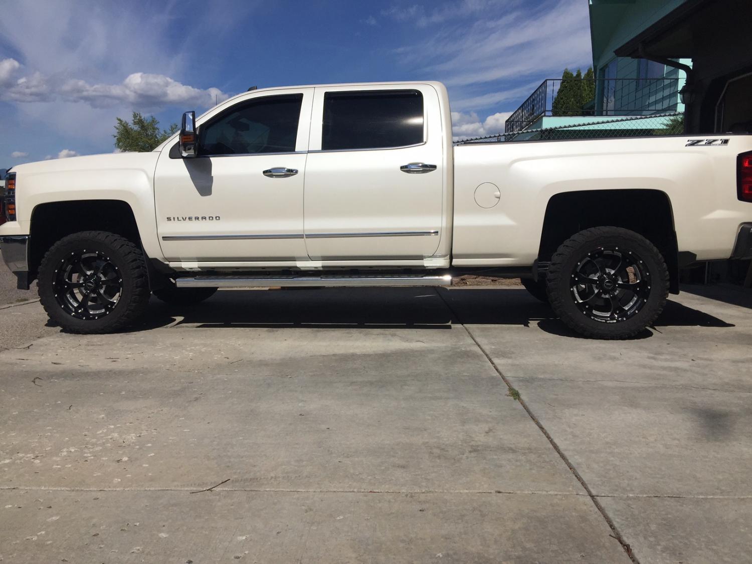

I just had this done to my truck, I had the 3.5" lift with the 2" rear blocks. I had them install the airlift loadlifter 5000 kit to my rear as well. The dealership called airlift to ask about spacers and it was confirmed that I needed them. They were only like $45 extra. Here is the result.
