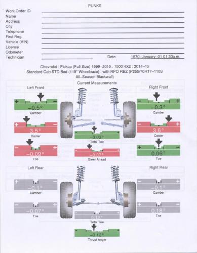

Alignment up next. Remember I bought this rig with 1300 very soft old man miles on her. The before is the factory setup. Look below for after. Do not kid yourself. The alignment man was not happy with my fussiness. I chose the specs and the tolerance, nil. Another hundred gone and well spent.
Tire wear is remarkable slow for a tire the press and key board reviews consider junk and a front end this messed up. I find it a pretty good tire. Just under 8/32” center ribs. 7/32 outer ribs. Lots of meat left in this set. I see no need to replace them.
The result?
1.) Harsh jar is gone on bridge approaches, tar snakes and small pot holes. Not plush but no bump steer either.
2.) Slow speed near lock judder gone and steering effort at all speeds is remarkably lighter.
3.) High speed turn in noticeably quicker and more precise. Less caster induced understeer correction required.
4.) Tire temperatures are lower and pressures now remain even.
5.) Coast down from 55 mph to 40 mph takes 50-75% more distance. That's huge.
6.) Included angle which had nearly a 5 degree delta is now zero. SLA - camber delta now 0.1
7.) Steer ahead now zero.
8.) Thrust angle is cut in about half. It can’t get better until the rear axle is squared.

This last tank is the first tank since the alignment change. The previous six point average was 25.93 mpg. A bit above the cumulative 25.56 mpg. The result of some warmer weather no doubt. The first point of the next six point is 28.45 mpg. A pretty big shift already but only the first of six.

Baby-baby getting the alignment squared went miles towards that. It is now eager to engage. GM says the AFM increases fuel efficiency 5-7%. Without any more data than a tank plus under my belt I’m going to say in this case, that is conservative, as I would expect GM to be. If I didn’t have the Scan Gauge to let me know is was toggling I wouldn’t know it was there.

Before alignment 1475 miles on 55.84 gallons of fuel 26.41 mpg
After alignment 1589 miles on 56.89 gallons of fuel 27.93 mpg
1.52 mpg increase for a 6% gain. That’s 28 miles more range per tank and gets me over my 500 mile wish list target.
Current total average for life of truck 25.7 mpg and climbing. Post alignment number is 9% above life time average.
