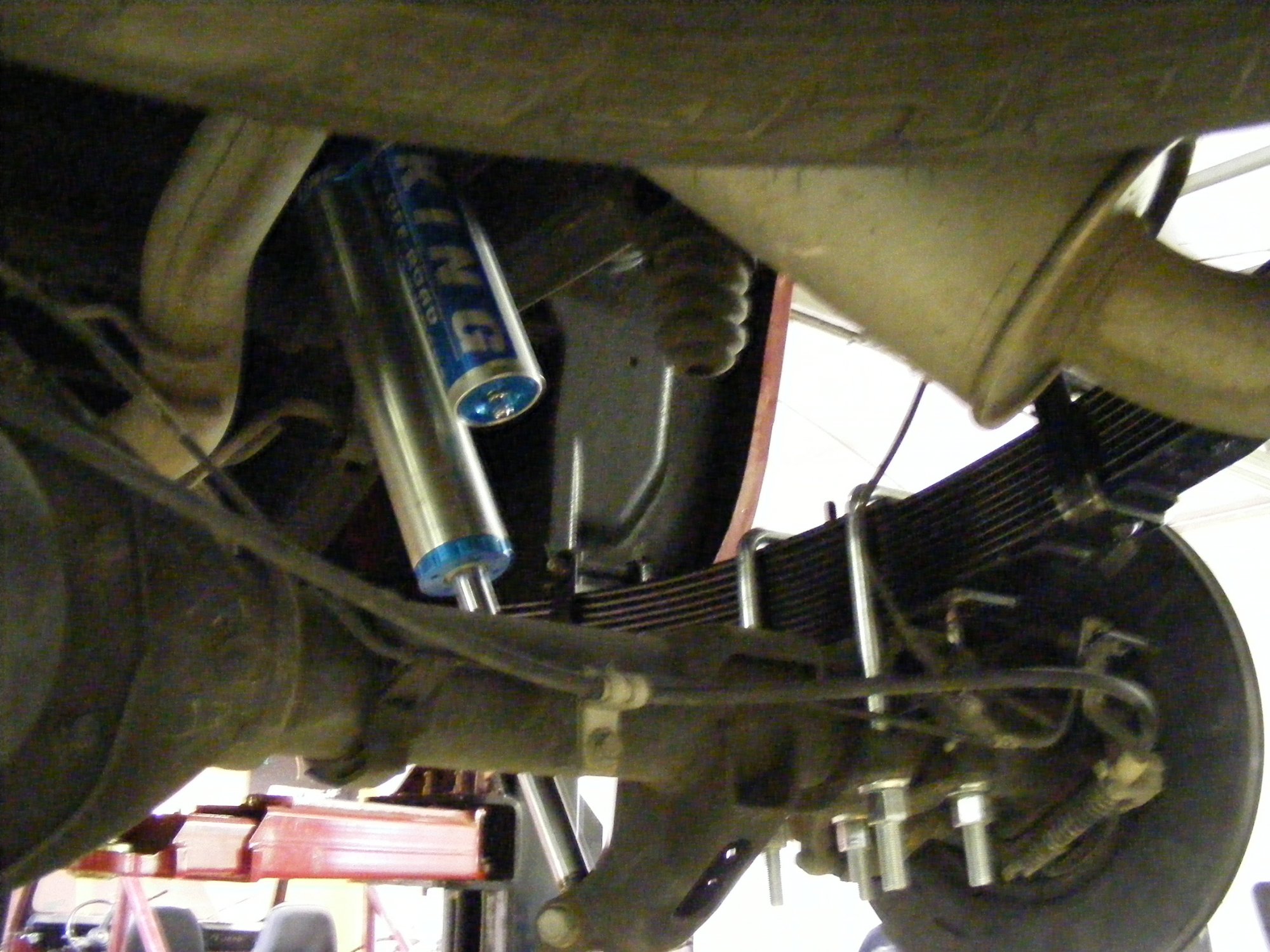

Deaver spring, Sulastic shackles and King shock in place. Now for the tough one.  That's allot of leaves.

Installation of parts is done. Now we tweak. Pinion angle, wheel alignment and bump stops.
I took some photos and measurements and sent to Ben for review. He will tell me what's what.
It did not produce a perfect 2" drop.  A very solid 1.5" was realized which gave a very pleasing 1"  forward rake. It will settle some over then next few thousand miles so this is great. I can always shim it taller. Just not shorter.  I think it made a huge visual impact. Lost that 'ducks eating in the pond'  butt to the sky stance.
I have over an inch more front travel and half that gain in rear travel. All four corners are perfectly centered in their respective travel. It doesn't get better than that to tune from.

And we have two new issues to deal with. First is camber adjustment. Extended camber bolts are ordered and arrived late yesterday. Too late to finish up last tonight. I actually kind of saw this coming mixing and matching parts like this.
This second one is just common sense but I didn’t foresee the fall out. When you lower your truck with the spring by taking out arch or shackles you close the distance between the axle and frame mounted bump stop. So you gain rebound range and loose compression range. The truck now sits as it would with about 1000 pounds in the bed. And there’s the part you don’t think about. Load puts energy into the springs. Sitting static at that same height it’s under no such load. That changes the amount of force the bump stop sees when first contacted. The bumper ‘acts’ as a softer secondary spring. Bump stops, urethane ones, are highly progressive. Each half inch or so it’s compressed takes about 5X more force…until it won’t compress anymore or the load is balanced to the load of deformation. So while the shorter distance limits up compression travel the bumper, receiving more energy defects further, more rapidly and abruptly.
So could you shorten it? Many do. It’s even in the instructions for some cheap tuner kits. But doing so runs two risks. First the part you are cutting off is the soft end (normally) so while it takes more travel to reach it it’s very harsh once it hits. That can totally upset the balance.
So let’s say the mount allows you to shorten the big end. Yep you get to keep the progressive nature of the bumper but now you run the risk of bottoming the shock or in the case of piggy backs, crashing the reservoir into the axle housing. It’s case specific and in this case applicable.
Thank goodness and the unforeseen only part of this lower was by the arch reduction method. The other part was in a lower spring rate which allow the truck to settle lower before spring force equals truck weight. Leaving the bumper then uncut puts rate back in once the bumper is in play and being highly progressive it will prevent the reservoir crashing the bump stop pad.
Look King did not intend on the OEM shocks to be installed in lowered trucks so this is all on me and I will get if fretted out.

Well the initial work is done and I have it back. Picked the truck up last night and by this evening have logged my requisite 500 miles. Back Monday for re-torques and moans.
So…every scrap of harshness is gone. Railroad tracks. Bridge expansion joints. Awful pockmarked Illinois roads and I went out of my way to drive the worst in my area then headed into Iowa to visit dad and ride some roads I grew up on that I’ve been avoiding since the first time I ran them in this truck. No need to dodge them anymore.  Don’t kid yourself, 1960 Cadillac it is not. More like a modern higher trim level pony car. Firm. Very firm. Almost hard but not harsh. Always in control and very responsive. There’s a double set of esses not far from here that are marked 40 mph and that number has been generous until now. 55 mph was a breeze. Can I do it faster? Who cares but I don’t have to slow anymore. There is only a front sway bar on the WT1 and I’m not sure I’m going to need one. The turn in is on cue and precise. Holds the line as pointed. Very confident feeling. Makes the tires feel like I just traded in my LT’s for Gumballs. Okay, not quite but very inspiring.
So all four corners were different heights. 500 miles settled everything in nicely and now that it has, it is dead level standing 37.25” +/- .0625” at the tops of the arches. That’s not a lift and not a lower. It’s a level done from both ends. Level enough that on level pavement an angle gauge on the bed sill is about as dead zero as it gets. I can literally move it either side of zero with two pounds of air from either ends tires.
Down over two in the rear and a bit over an inch up in front. I stopped at four dealerships today and found about a half dozen of my model that measured roughly 36” up front and 40” out back.
