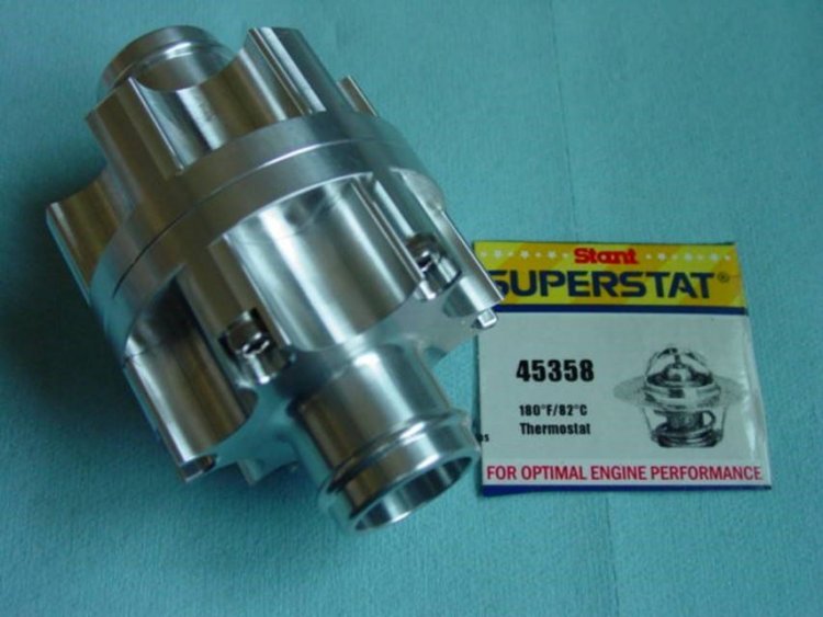

Jet 170 F Thermostat failed....again....time to try something else. She's going to sit awhile now.

I haven't done the postmortem yet but if it follows suit the gasket is what fails. Leak by is bad enough it might as well be open. This time however it is modulating just 10-12 F colder than normal and less controlled. It is a Jet Performance piece and the third and last item I will source from them. They have stood by their warranty but this is silly. If it would have been a Stant it would last longer than the truck. Stant does not make a unit for these Ecotec3 motors but I can fit one and will. I WILL have my way with this thing. :lol:

Contacting a machine shop to make an inline thermostat holder I can cut into the upper hose. Of the premanufactured units I found not a one was sized for the odd radiator hose ID. Good job GM! IF that doesn't work out I'll buy a chunk of 6061 and spin it up myself.

Thermostat housing ordered today from IPSCO.Org. Mid week next expected delivery.
These Ecotec3 motors use an oddball sized hose at 33 mm (1-5/16) No one makes one that size and there was a two week lead on custom order. 1-1/4 it is then.
Stant #45358 180 F SuperStat and Flepro #35710 Seal.

BTW, that inline thermostat housing looks HUGE but it is only 3" in diameter. They need to sit something beside it for perspective.

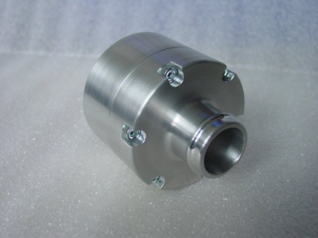

Ever get a really, REALY nice surprise? I contacted Mark Johnson of IPSCO.ORG yesterday asking for a tracking number, shipper and date of expected delivery. I had forgot to get that info when I placed the order. By yesterday I was getting nervous. Didn't hear from him...hum... I had mentioned that I was a bit concerned about the device weight when I placed the order and we talked about that briefly....and then I dropped it when I realized the photo I was looking at was without an object reference. It's only 3" in diameter after all.
He didn't drop it. He responded today with a few photo's of this work of art that was shipped today. He didn't want to reply until and unless I was getting exactly what I wanted. I am stunned at IPSCO's, Mark's commitment to excellence. Why stunned?  He took this upon himself; spending his time and his money to write the code.....He spent more on the code/setup than I paid for the part including shipping. I would expect to see this on his web site and in his order books soon.
Floored, simply floored. Thank you Mark Johnson (ISPCO.ORG).

Please excuse the mess during the remodel. Installation and operational details to follow soon. Real soon.
Refresh my memory. You installed this for what reason?  It is a true piece of art that is for sure.  True craftsmanship and high quality work.
